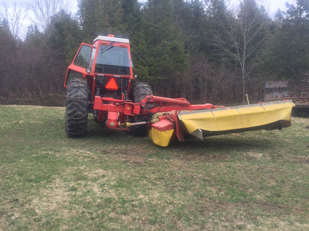

Well a little testing today.  I normally run this mower on my 82 pto hp Massey 5455 but I hate swapping it on and off every day of haying season and could use a few more ponies.
Mounted it on the 7010 and... front end comes up when you let up the clutch or bump the powershift to a higher gear, was not expecting that on a tractor this much bigger!  With it swung to the side the 18.4x38 is not happy doesn't show on the outside but the inside was squashed right down.  Driving around the yard about scared the brown stuff out of me.

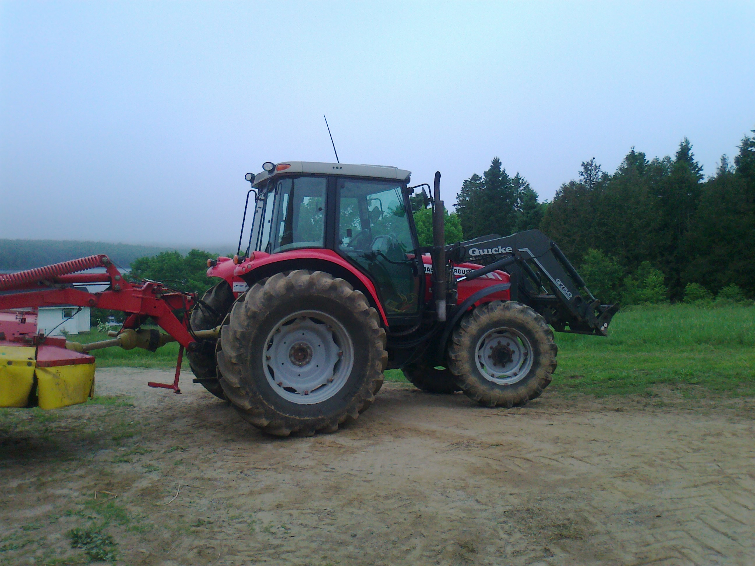

For reference, the MF 5455 it normally rides on:

even being a smaller tractor I would think with FWA and a loader would make it heavier on the front than the 7010. Put some suitcase weights out front.

Your 7010 does not have a fwd axle and loader to keep the front end down - you need to keep that in mind.  It seems most of these tractors came with front weights, but it also seems most previous owners took them off for some reasons.  If you ask around, you might find someone that has a set.  With the squatting rear tire, you might want to check the pressure, should be around 15 psi.

Yeah they removed the weight bracket to fit the plow mount.  I may have to make a rock box.  I have a few 150 lb lead weights that I could sit in the bottom.  I just assumed the 6 cyl being longer would keep it planted as that little 4 cyl doesn't even think about rearing up.  I used to run it with the tires all the way in before as well but the hillsides were not fun when the mower hung downhill.
