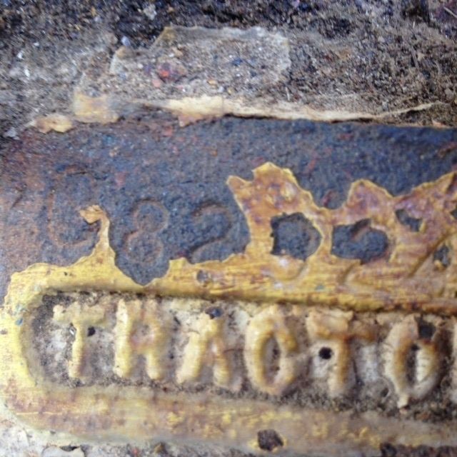

I have a C that has the serial number of 82924, which according to the serial number guide on this website would mean that it is a 1950 model.  However, I am confused because I thought that the later models of this tractor were made with a distributor.
Were they also made with a magneto, or is the chart that I'm looking at wrong?
