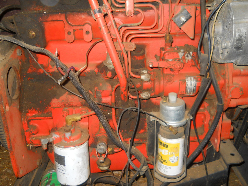

couple pic one of my car and one of the engine
HD6GTOM View Drop Down
Joined: 30 Nov 2009
Location: MADISON CO IA
Points: 6627
Post Options Post Options   Thanks (0) Thanks(0)   Quote HD6GTOM Quote  Post ReplyReply Direct Link To This Post Posted: 25 Jan 2016 at 8:34pm
That is a lot newer engine than I have delt with. Should be the heaver bottom end. I have attended the Good Guys car show in Des Moines, every now and then you see one with a diesel. Good luck, don't get discouraged and give up on it. Please post pictures of your progress.
