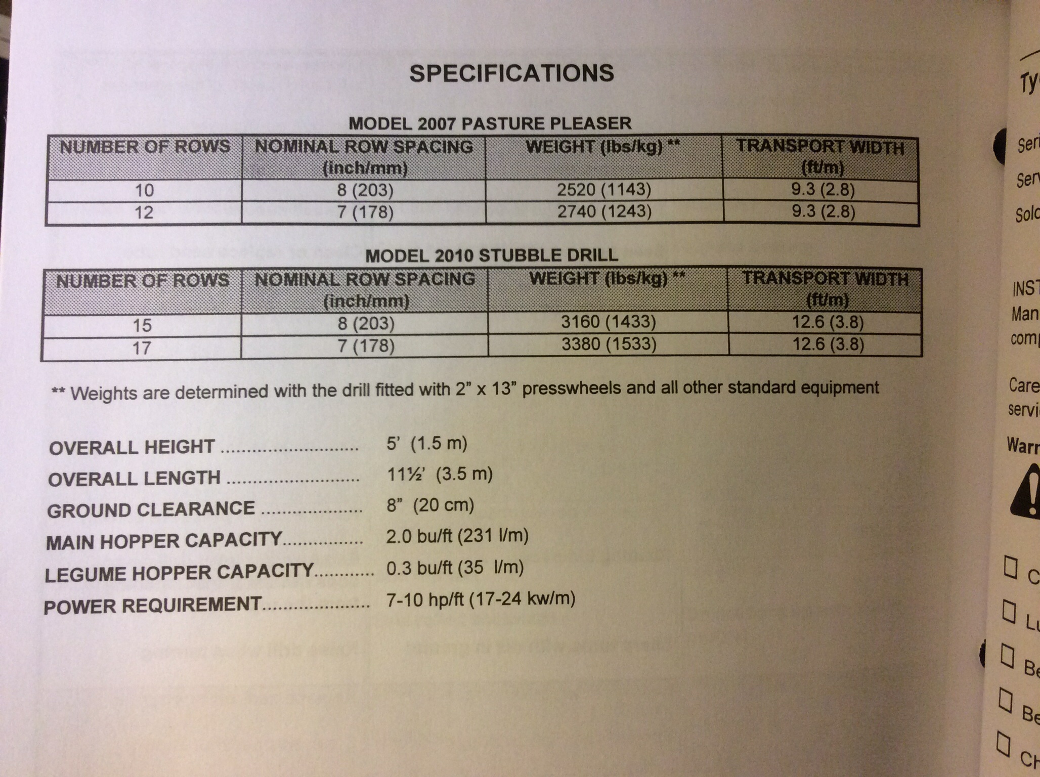

This is from the manual for the tow behind 7 ft Pasture Pleaser:
Maybe this will give you some indication of the weight.
