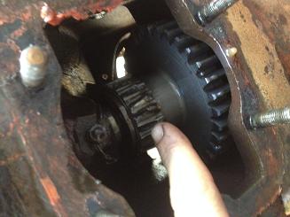

so i found my issue, and the part where i said i was gonna see if any pieces fall out was not so funny. intermediate gear is almost round and all the teeth are on the floor or in the pto housing now. looks like i'll get a lesson on how to replace one. from what i'm reading, i have to remove the entire torque tube assembly and clutch?? little more work than i was hoping to do. guess i'll know more about my tractor after i'm done though. if anyone thinks i can replace that gear w/o taking the clutch out and torque tube apart, by all means, say so. otherwise, that's what i'll do. for the time being, i think i'm going to pull the gear from the top of the pto housing and put the housing back on w/no pto drive just so i can put fluid back in and still use the tractor. is this a bad idea? it doesn't appear to me that it will hurt anything but i'd rather hear from someone that knows. thanks gang

the pto gear, bearings and shaft look ok to me, so my plan is to put them back in w/o the gear in the top of the housing so it doesn't grind anymore, until i can get the parts and replace everything

Intermediate gears can be changed by removing the hydraulic pump and sliding the shaft out of the way. No need to remove the torque tube.

I had that exact same situation, and the reason was that a pin from the hand clutch got spit out, and found it's way down through the gears. Look about halfway down this thread for photos and explanation:

Your problem with the intermediate gear is not uncommon, another cause is from the pto not being fully engauged. Also bush hogging is hard on these gears. Dr Allis is right as usual on the replacement of it. Job is easier if you have a helper to hold the spacer washers and to help line up the shaft as you slide it in but job can be done by one person. Keep us posted on your progress !!

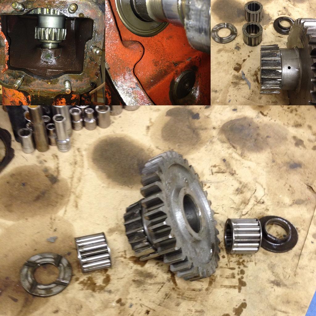

I got the idler gear out and it looks to me like it should have had a key which it did not. I'm w/you though Dave, I'd really rather just fix it while it's apart. I'd love to find good used gears, but not sure there are many around here. For no more than I need to use the tractor right now, I'll think I'll just save up and get new gears. Motor leaks oil all over, so I really to get all those fixed before I run in to some real problems.

Check with ANY of the guys that have parts machines here- I got mine from Bill Deppe... and the way those gears are, they're either good, or bad... usually they're good unless something falls down into 'em.

update on tractor is i found some used gears from a guy on here. also pulled the hydraulic pump. that there job is not easy Wacko but, assuming i can get it all back together, that part of it is done. anyway, hope everyone is having fun playing with their tractors! take care gang

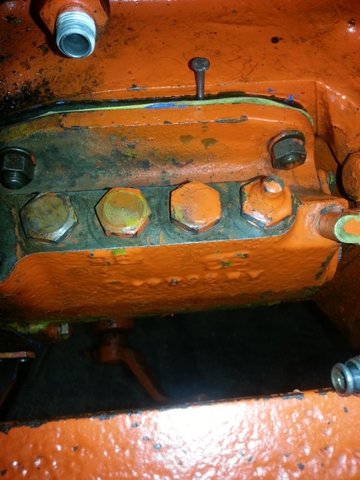

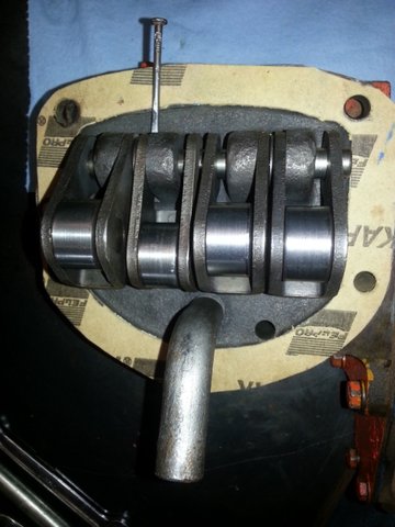

Someone recently posted pic of the "nail trick" when installing hyd pump.Flatten end of 4 nails,press roller lever against body and wedge nail between body and lever.This will keep all levers collapsed out of way when reinstalling pump.Once you get it fed in past frame rail with draw pipe inside housing,pull nails out and bolt up.You can have a gasket glued to hsg and never disturb it doing this way.
The shaft uses that set bolt to lock in place.No key needed.

i believe this is the pic your talking about.                                         i would put the gasket on the tractor instead of the pump

pretty slick trick! that pump is WAY cleaner than mine. mine will be clean and freshly painted when it goes back in though. the gasket was in bad shape and fluid had leaked all around it, making a huge mess of that entire area. hopefully i'll get that all fixed up and be leak free Wink thanks for the tips guys. sent out the $ for my pto gears and some other parts i needed today, so i gotta get busy cleaning up all the parts to put it back together. went ahead and cleaned, sanded and painted the parts i pulled off in the process of fixing the pto. gonna look a lil funny since i haven't painted the torque tube or transmission or anything yet, but the fresh AC orange looks awesome and i just couldn't help micelf. i'm prolly gonna make some enemies here because i decided to tweak the original paint scheme a lil. not a huge fan of the ALL orange, so i got some IH white (which is like a cream color) that i'm putting on as like a trim color just to break up the orange a lil. also painting all the nuts and bolts i pull black. so, i'll post pics as i go and see what you guys think. hope everyone is having a good week....more to come

for those of you that are like me and have never taken one of these off, here's what a hydraulic pump looks like. that lil' guy is heavy and hard to get out! i've cleaned it up quite a bit and will sand and paint this week (i hope) then wait for my gears to come in and put it all back together hopefully next week
