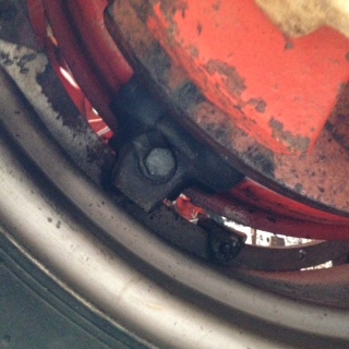

The right hand wheel on MY WD was set all the way in with both stops on either side of one excentric matching up with holes in the rails. Both had slugs extending through rail holes behind each bolt. When I moved the wheel out two inches to 26" from tractor center neither rail stop matches up  with a rail hole.  Should I be concerned about this?

Without the stops it will not stay were you have it set. Over time it will work its way in or out or it may move if the tire spins or when it is under a heavy load. Your best bet would be to move it in or out to the next stop.

The stops have to be lined up with the holes. You couldn't even tighten them up if they were not in line with a hole as they have to go through them. Do you have the proper stops for your rim?? They made 2 different stops and rails as I found out on my D17. Pictures would sure help so we could see what you have going on here.

What you describe as having rail holes corresponding to only all in/out or in the middle is what I have. Sooooo, the question is how does a guy set the wheel for a 16" plow at 26" from the center of the draw bar to the inside of the tire without rail holes to set the stops in?

Without the stops it just makes it harder to adjust to where you want it.  Trial and error is the plan of the day to set it for an exact location without the use of a stop.

The rail stops were meant for ease of adjustment to different positions, you can put the wheel anywhere in between wide and narrow and clamp it up. If the wheel won't stay where you put it without a stop, you have a problem with the eccentrics not clamping tight enough.
 It might be easier to jack one side up at a time and set them by hand to get a point in between the stops to a certain measurement.

Thanks to all! I have the wheel set at 26" but was worried about placing the stops on the rails without holes to bolt them too. Sounds like in this position the strops should be removed and thrown into the tool box?

Run the wheel out against the stop, put in the other stop and tighten the eccentrics at the nearest position to the width you want.  Then if the plow takes too large or too small a cut with the first bottom, adjust the plow on the frame until it is correct, and you have every thing set for this tractor/plow combination.
Many times the front bottom will take too large a cut at the factory recommended settings because of worn landslides.

Well since this has been going for a couple days I dug out my plow manual. on page 5 it states. set the tread width at 56" for 14" bottoms and 61" for 16" bottoms. looking in the WD manual on page 24 56" tread all the way in. stops removed. 61" is with the wheel at the next stop. Have you looked in your plow manual to see what it says about tread width. I've found that adjusting to the manual should be your best starting point. you can tweek from there to try and make it better. I just used the recomended setup and its pulled so easy that ive never changed it.
