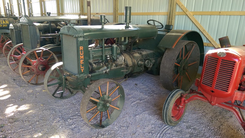

This is the tractor by the way, I thought I posted this pic before but maybe not. All original except for paint, the guy who owned this only bought really nice tractors and took good care of them. Been stored inside for 20+ years and turned over every year so not stuck. Should clean up real nice.

Post Options Post Options   Thanks (0) Thanks(0)   Quote torque tube Quote  Post ReplyReply Direct Link To This Post Posted: 30 May 2015 at 7:40pm
Good looking Rumley 6a should not take much to get her going. Check those fluids good especially that oil bath clutch . Good luck
