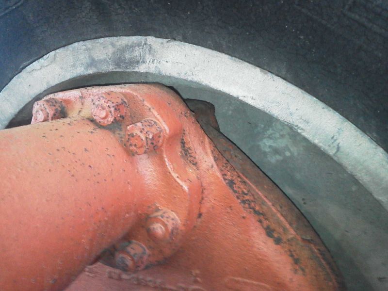

I think I tried that many years ago and the inside of the rim rubs on the upper 2 bolts of the axle cover.

I have a set on one of mine. But I have 170 flat top fenders on it. I found the same thing that Gary said. So I put them on opposite sides. They stick out more, but clear the top of the final drives.

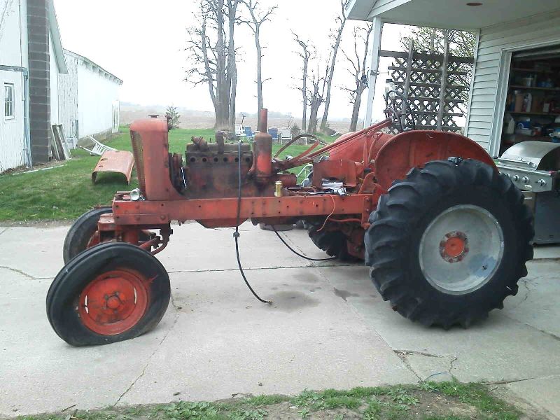

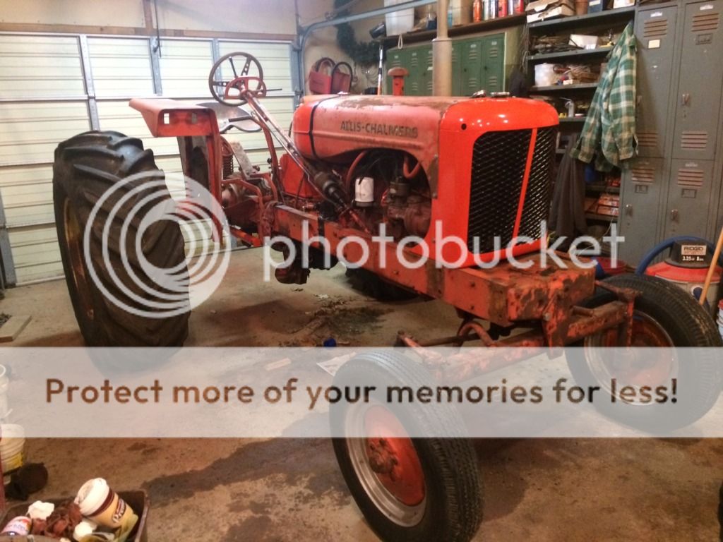

Depends entirely on the wheel's interior shape.
These are 14.9-24s, on heavy galvanized steel irrigation boom wheels on my '50 'Schwartz'. Overall height is 52", and with the wheel set facing out, my track width is 90" There's no clearance for valve stems on the inside, but plenty of room for them on the outside.
