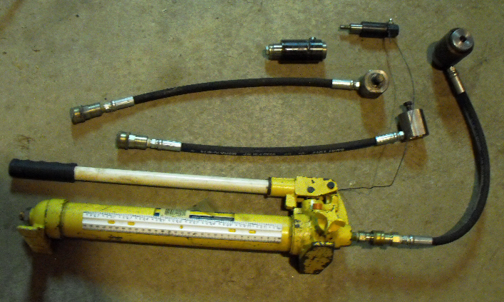

When I replaced the steering clutches on my HD6G I could not find the tapped hole in the brake band pin because there wasn't any. On one project a previous owner put the pin in backwards. Another steering clutch repair the previous owner replaced the pin with one that was not tapped.
I posted "steering clutches again" 15 October, 2013 where I made a small hydraulic cylinder to push the pin out. You can find it with a google search. I remove the upper section of the brake band in order to remove the clutch pack.
Another forum post "what is the tensile strength of a mouse nest" 19 Aug, 2012
I like hydraulic cylinders for working on steering clutches.

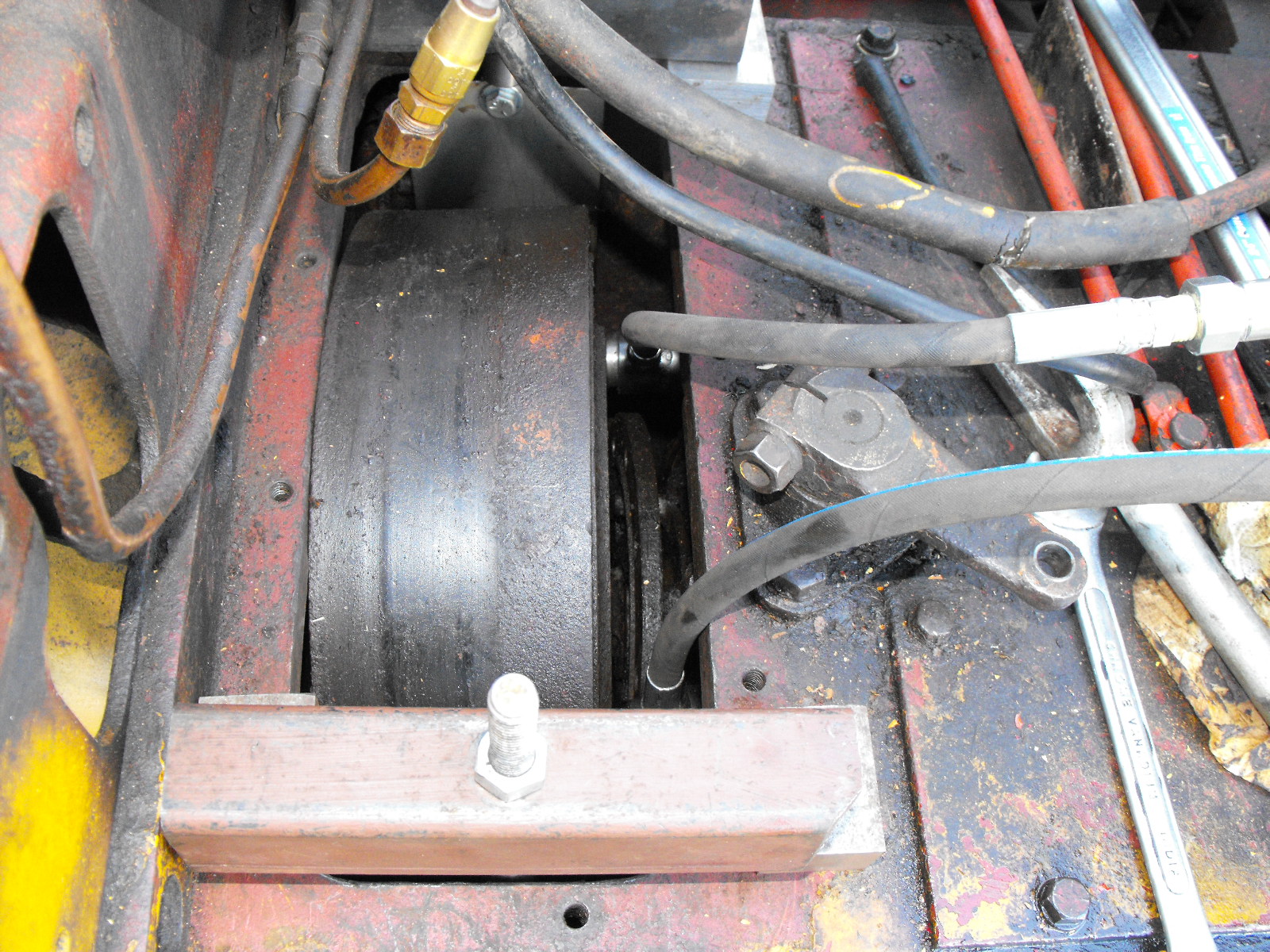

Note the amount of clearance. This was not enough. I was able to get the top of the drum above the cavity opening and it was still stuck. When I pushed with my hydraulic cylinders I tilted the clutchpack in the drum. Parts of the clutchpack moved into the drum more than others. I rotated the assembly finding a spot where I was able to lift the drum the most. Then I got brutal.
My engine crane was unable to lift the assembly further so I used a hydraulic cylinder with the crane. It came out a little at a time. I was unable to find any shiny metal to indicate exactly where it was hanging up. This was my most difficult steering clutch repair. Hope this helps.
