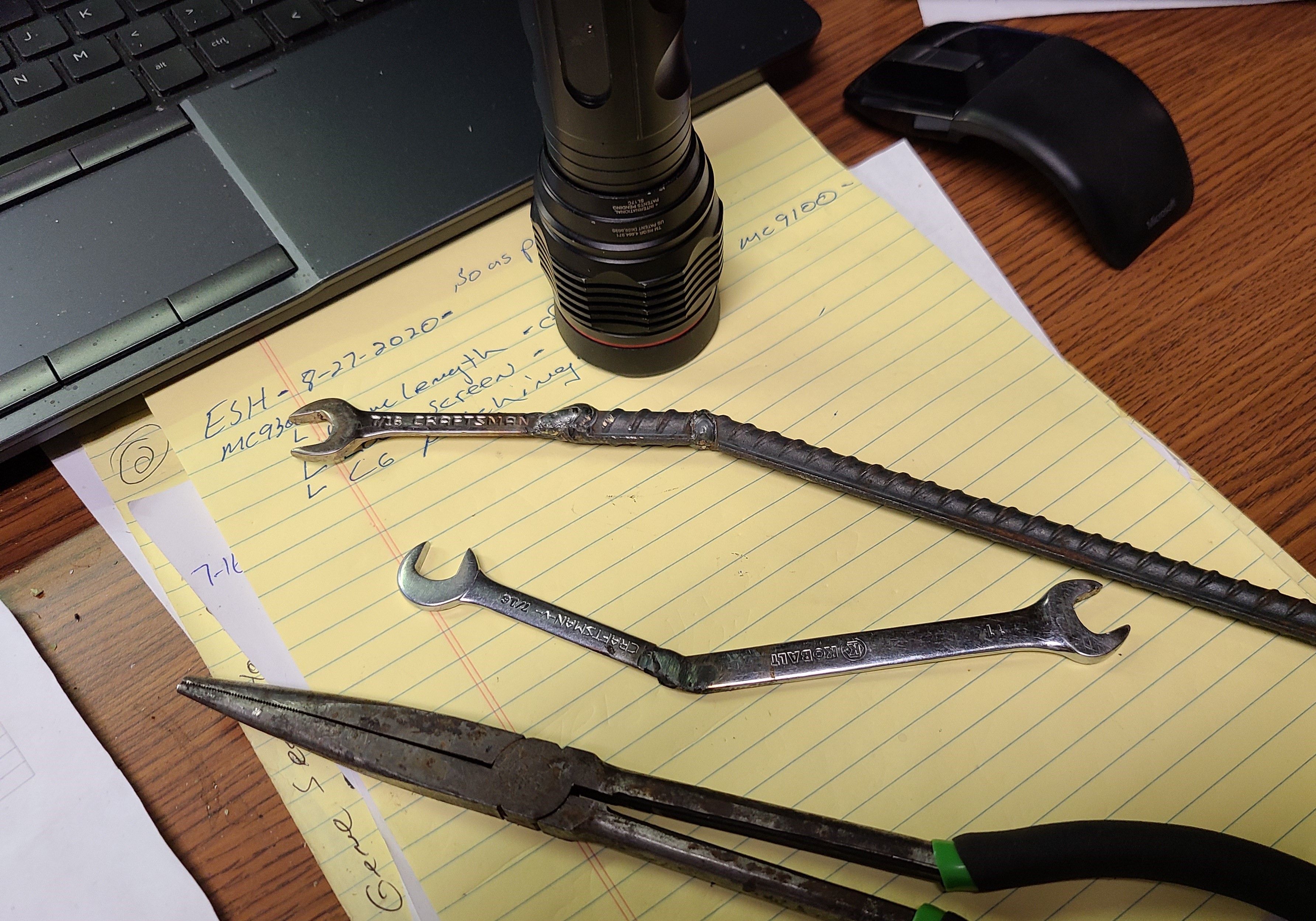

Tools needed to adjust the clutch on a D series

I had to be creative... Also patients and holding your tongue in the right position help Smile

Thanks for posting this Terry . I may have to resort to something similar . I'm guessing this is adjust the clutch fingers through the inspection hole ?

Whoo. I don't have a D17, but this looks like an awful pain in the rear. What's the procedure?

No problem AC, so far then I had to bump the engine over to catch the fingers in different positions.
Good luck hope this helps

there's about a 2 inch diameter hole on the bell housing where you try to reach a 7/16 bolt.
Trying to adjusted Each finger quarter-inch off the of throw out bearing
