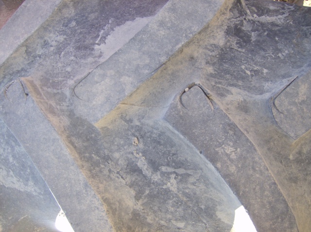

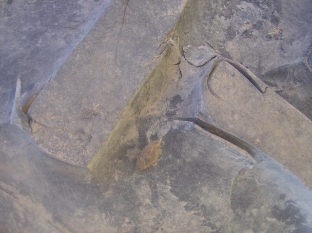

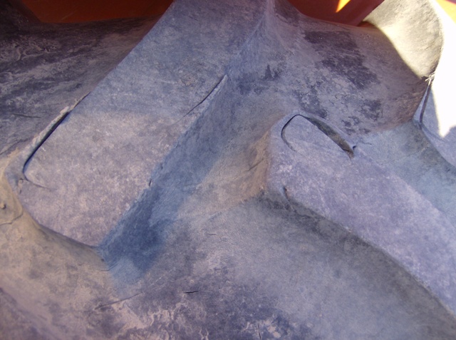

Any way to tell if a tire has been re-lugged?  I have some old Goodyears that tire guy said looked like they may have been, can tell there are different layers.

Can you post a close-up photo of the lugs?

Post Options Post Options   Thanks (0) Thanks(0)   Quote Jordan(OH) Quote  Post ReplyReply Direct Link To This Post Posted: 01 Nov 2010 at 8:48pm
Jordan(OH) View Drop Down
Location: Celina, OH
Points: 1563
Post Options Post Options   Thanks (0) Thanks(0)   Quote Jordan(OH) Quote  Post ReplyReply Direct Link To This Post Posted: 01 Nov 2010 at 8:51pm
JoeO(CMO) View Drop Down
Location: Cent Missouri
Points: 2696
Post Options Post Options   Thanks (0) Thanks(0)   Quote JoeO(CMO) Quote  Post ReplyReply Direct Link To This Post Posted: 01 Nov 2010 at 9:48pm
The relug appearance I remember had like steps around a wall, each layer was approximately 3/8 inch smaller than previous layer, 4 total and final was the lug itself. HTH

Post Options Post Options   Thanks (0) Thanks(0)   Quote HD6GTOM Quote  Post ReplyReply Direct Link To This Post Posted: 03 Nov 2010 at 1:26pm
The pictures show normal wear on and older tractor tire.  i used to see this a lot on them.
