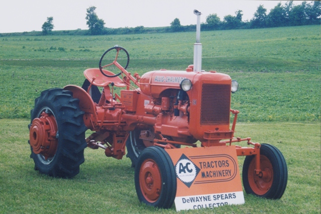

Post Options Post Options   Thanks (1) Thanks(1)   Quote DSpears N IL Quote  Post ReplyReply Direct Link To This Post Posted: 07 Sep 2023 at 3:51pm
I started out with 11.2 x 24 Firestones on 10” standard rims.
I changed to 13.6 x 24 Firestones on 12” rims which are taller and are Very close to the fenders! Maybe about 2” taller raise but about 4” taller with the outside diameter!
I have since gone back to the standard rim& tire combination.
DeWayne

That is a beautiful CA DeWayne!!! Can you show me more pics of it so I have something to dream about with mine, LOL
