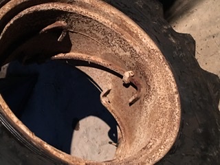

After getting the tire off the tractor the rim has been split and 7 inches have been added to the inside making   a total 18 inches  outside to outside. With no rails on the inside the tire can be moved in till it almost hits the finder. The tractor has a 170 picker on it and the wheels shifted all the way clear it by an inch. The rims look to  have been modified by a shop or skilled welder. This size tire is great for traction and flotation.

Here are some pictures of the wheels that was sent to me.
