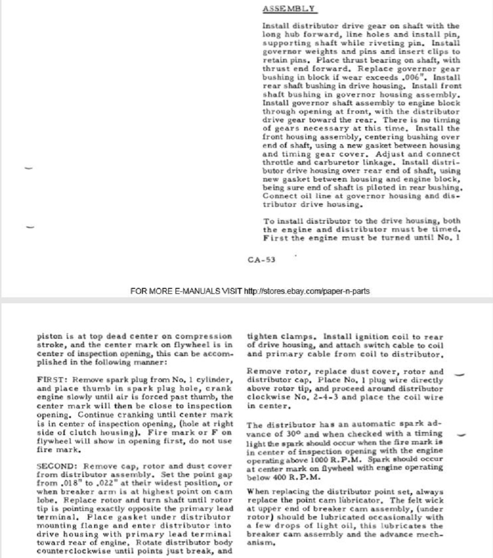

OK, thanks guys!

Post Options Post Options   Thanks (0) Thanks(0)   Quote Jim.ME Quote  Post ReplyReply Direct Link To This Post Posted: 27 Apr 2019 at 2:22pm
To go along with Dick's post, here is what is in the service manual.

Post Options Post Options   Thanks (0) Thanks(0)   Quote Dick L Quote  Post ReplyReply Direct Link To This Post Posted: 27 Apr 2019 at 2:08pm
Originally posted by LouSWPA LouSWPA wrote:
conventional, non mag ignition, set the static timing with the F on flywheel, right? oddly enough, this bit of info is not in the ops man
No! Static timing on any engine be it tractor, truck or car is at TDC. On the Allis engines the F will be in the center inspection hole when running wide open with a timing light. I know that you already know that it is TDC on the compression stroke.
It would also be the same as I just posted for the G where the points need to be closed just ready to open.

Post Options Post Options   Thanks (0) Thanks(0)   Quote LouSWPA Quote  Post ReplyReply Direct Link To This Post Posted: 27 Apr 2019 at 1:57pm
