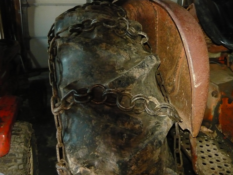

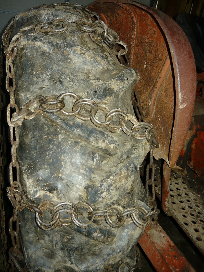

Due to the extremely wet spring and summer we had, we were unable to get into a portion of the woods. Now is the time, I think, to get in there and get out what we need. Kicking around the idea of tire chains for the WD, we may be working well into the winter.
Any experience or advice? Reputable place to buy them? Anybody got a used set they no longer use?
I am leaning toward logging chains with the huge links, not the worthless lawnmower ones that are made from the same chain as my dog tie-out.
Pretty sure they are 14.9X28's.
Thanks in advance.

Used them on the 170 plowing snow.  Found that I needed to use some wire to tie the outside latch  closed so it doesn;t come loose.  Not much fun when it lets go on the outside, and wraps around the axle a few times before getting under the tire and bringing the whole thing to a sudden stop.
Agree the type that has a ring in the middle of the tire, or an H pattern to keep the cross bars from dropping into the cleats is preferable.  Straight ladder chains are less useful.
Could push snow almost to the front axle with the chains on.  Would have been stuck many times without them.

These are what I have on my WD with the loader for moving snow. With these and loaded tires it is almost impossible to get stuck.

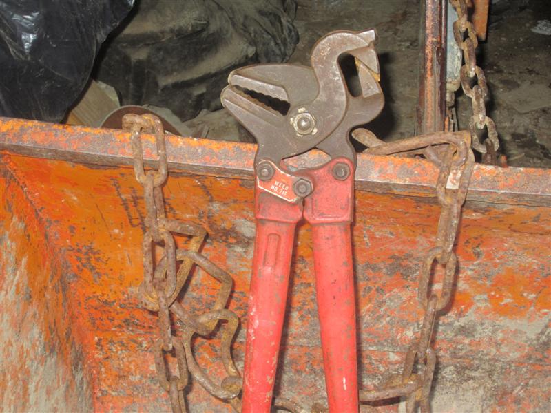

I picked up this tool at a garage sale a few years ago........
Chain Pliers.......This one is made for heavy truck and tractor chains.
Makes the job of replacing cross links a real breeze.
The "scissor" end opens the link and the "pliers" end closes it back up.
As someone already said, lengthening the side chains can be real easy
as well by cutting a link, installing the extra links and welding the connecting link back together.

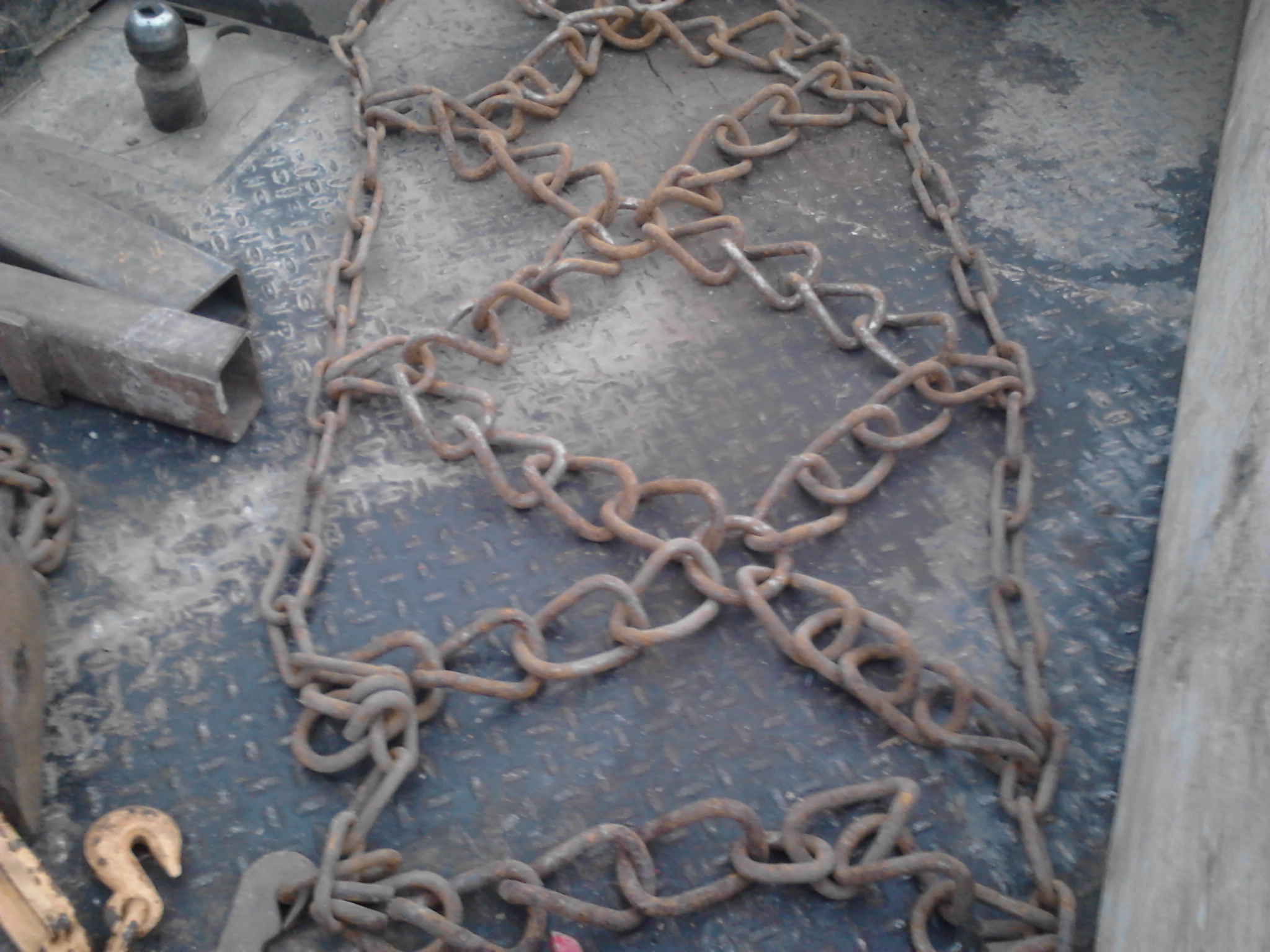

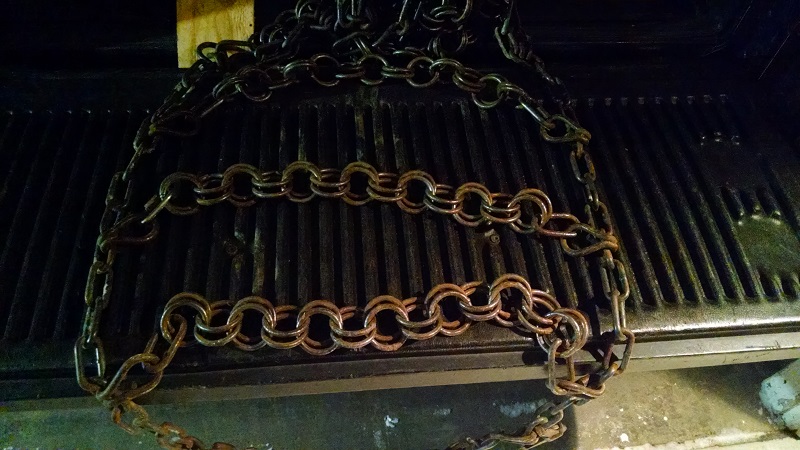

Well, Ted was nice enough to measure his chains for me, he says they are about 2' wide and 11' long.
Got a pair that are supposedly fit 13.6 by 38's. They measure about 16" by 13'. They are worn, but I think they will run a long time yet.
So, they are the big links, in a cross pattern, should work good.  I'm a little concerned about the width, but the only way to be sure is to try them. The owner dug them out of his shed and told me to take them and try them, if they work, he said $100 would be O.K. Considering how brand new double link chains are $340 a pair new, that's not the worst.

If they are too narrow Ryan they will tend to slip off the tread and then you've got problems.  They should fit AT LEAST 1/4 of the sidewall from the tread.  I hope you get lucky!  That's a good price.  Actually not a bad price even if you had to buy come extra cross links and put em in.  Course I don't know what it costs for extra cross links to add on. Confused

I've used just regulary chain to make them wider in a pinch while not as good as regular cross links...better than none!!

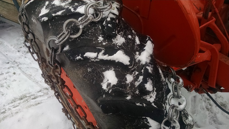

Well, I tried that set of chains, they are too narrow. When installed, the side chains are pretty close to the end of the lugs, and I'm sure they will slip off. So, I returned them to the guy and said thanks, but no thanks.
The very next day, scored these off of Craigslist. They look to be in pretty good shape, they measure 28" wide by 11' long.
So, we will try them out next time I am up to at the farm.
Edited by littlemarv - 07 Dec 2017 at 4:57pm
The mechanic always wins.
littlemarv View Drop Down
Joined: 10 Jun 2013
Location: Wisconsin
Points: 1829
Post Options Post Options   Thanks (0) Thanks(0)   Quote littlemarv Quote  Post ReplyReply Direct Link To This Post Posted: 10 Dec 2017 at 8:54pm

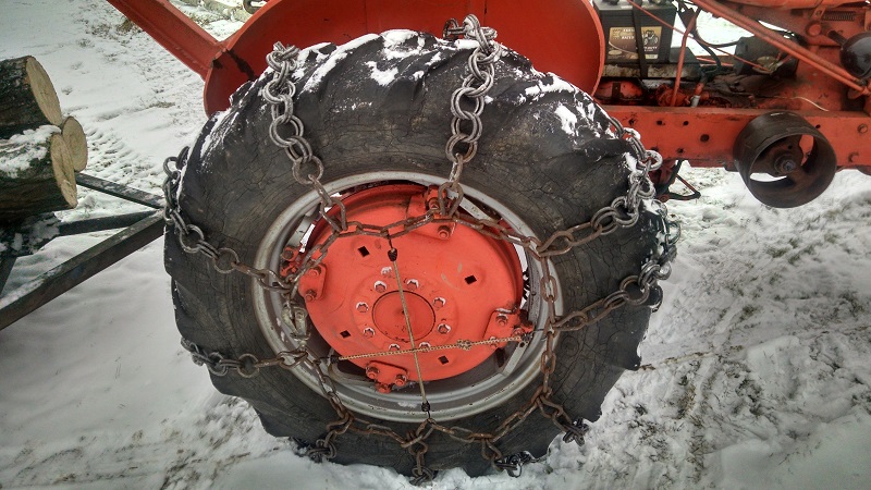

Well, threw the chains on today. They must be for 14.9 by 28's, I had to cut quite a chunk off. So, now I have extra side chain and cross chains.
When I have the time, I may narrow them up by a link or two. But for now, I tightened the inside side chain as much as possible without rubbing in the top of the axle housing. Then took up all the slack on the outside. Looks a little funny, but it works.
Pa imparted some paternal wisdom on me:
Me: " Maybe I should take those chains off and narrow them up."
Him: "Did they fit?"
Me: "Yes."
Him: "Did they fall off?"
Me: "No"
Him: "Did they slip?"
Me: " No."
Him: "Did they hit the tractor?"
Me: "No."
Him:"Drive."

looks like the same type I have on the d14, work great. if it ain't broke don't fix it..lol
Points: 18923
Post Options Post Options   Thanks (0) Thanks(0)   Quote Ted J Quote  Post ReplyReply Direct Link To This Post Posted: 11 Dec 2017 at 12:25pm
Yep, shouldn't be too much work to cut a couple of the rings out and make them fit.
BUT,,,,,,,,what if in two years you find that D-17 with the 14.9s or 16.9s on it??  If it ain't broke, don't fix it......
