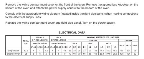

Okay, so the oven is currently wired for three phase, you wanna run it on single.
IF it's a common oven, it uses resistive elements to provide heat.  you do NOT want to run this on a VFD, and it would be a fool's errand to do so, because it is neither economical nor necessary to do so...
A sensible engineer would NOT have designed it to REQUIRE 3 phase... they'd only do that to make for a convenient connection for a building that provided 3-phase, but a sensible engineer would have set up an interconnection panel upon which you could either rearrange identified wires, or move jumper links, to allow it to run on probably a half-dozen different voltages and phasings.  Before anyone suggests that the FAN MOTOR might be three-phase, I'll say yes, it COULD, but NO ENGINEER with a brain would have ever done that... they'd simply use a single-phase capacitor-start fan, and power it across one of the elements, so that it no matter HOW you do the interconnections, would always be running the proper voltage... and the proper direction.
What you need, is a wiring diagram for the oven, and I'll BET that if you find an installation manual for it, you'll find that diagram, and in it, a connection diagram for SEVERAL different power configurations.
Can you get one?  Take the covers off, and look-see if there's a diagram either glued to, or in a pouch inside... or web-search, call the manufacturer, etc.,...
If you get a doc, and don't know how to interpret it, send me good pictures of it, and I'll tell 'ya how to do it.
I'm POSITIVELY CERTAIN that, even if it was wired for 208, or 480, or 277, or 230... it'll run on a 120/240 single-phase.
As an example, the most recent electric oven doc at Vulcan, page 5, has this:

I bought a resterant 3 phase Grill for our church the deal was too good to pass downloaded the manual from the manufacture and connected it up according to the manual for single phase. I connected to a range plug so we could plug it in when needed. the heat elements won't draw any more power than they can get.
