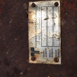

Thompson/Thomson D-17

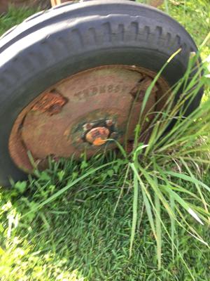

Post Options Post Options   Thanks (0) Thanks(0)   Quote lowell66dart Quote  Post ReplyReply Direct Link To This Post Posted: 07 Oct 2019 at 2:26pm

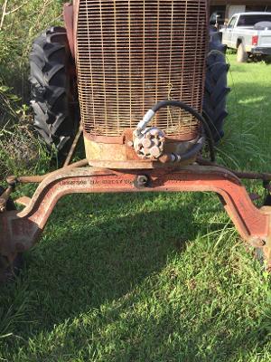

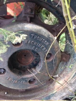

Check out the spelling on the wheel and axle castings......

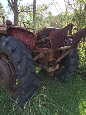

Post Options Post Options   Thanks (0) Thanks(0)   Quote lowell66dart Quote  Post ReplyReply Direct Link To This Post Posted: 07 Oct 2019 at 2:28pm

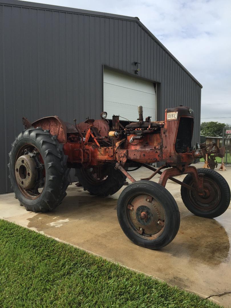

What does one do with this hitch?
It's a 63 model, diesel and it is supposed to run. I understand that these were hard starters. Anyone know of a gear reduction starter that will work.
AC 6080 (8030,7060,200,175,D-17HC, 6040,160,6140 all gone) Farmall 1066 & 656 Hi-Clear (for sale), White 2-62 High Clearance, JD 4255 Hi Clear.
Richardmo View Drop Down
Location: Rolla mo.
Points: 1746
Post Options Post Options   Thanks (0) Thanks(0)   Quote Richardmo Quote  Post ReplyReply Direct Link To This Post Posted: 07 Oct 2019 at 7:26pm
Should not need a gear reduction starter.
Does need a good battery and the manifold heater working.
If no heater just a little bit of ether and they will start as long the pump is good.
The hitch was used for the cane equipment,
They could use the row builder that was used on the WC or WD/UC cane tractors.

Post Options Post Options   Thanks (0) Thanks(0)   Quote lowell66dart Quote  Post ReplyReply Direct Link To This Post Posted: 14 Oct 2019 at 7:42am
Got some things taken off without breaking a bolt!!! Gave it a good bath too. I need to rebuild the battery box and rewire it next. Posted an ad in the classifieds for things I need so far if anyone's parting a D-17.

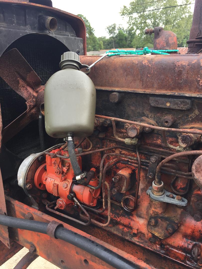

Got it fired up this morning, I built a new battery box and made new cables and got a new solenoid. Took the end of the starter off and the brushes look new. Using a temporary tank and switch. Turned it a few time till I got fuel at three injectors, gave it a tiny shot of starting fluid and off she went. Only ran it a minute because I have no water in it. I found a used preheater and thermostat housing this morning and their headed my way so next week I may be able to drive it around.

I had pulled the tank to clean it so I rigged up this temporary tank. Don't forget about the return line to the tank. Ask me how I know:)

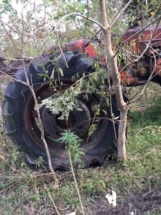

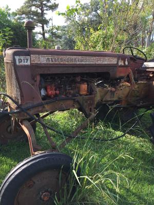

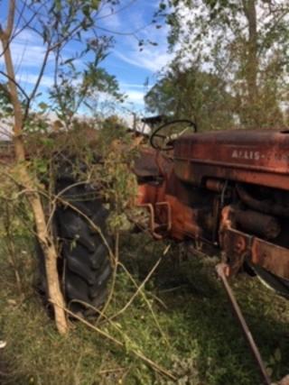

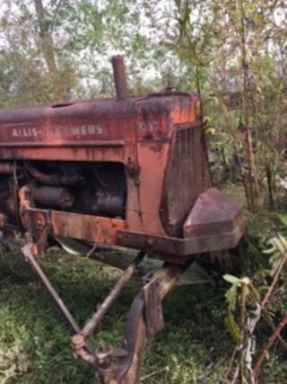

Post Options Post Options   Thanks (0) Thanks(0)   Quote lowell66dart Quote  Post ReplyReply Direct Link To This Post Posted: 04 Nov 2019 at 7:43pm
Found another Thomson yesterday. I hope the exhaust manifold is ok. Here's some pics for the Thomson freaks....

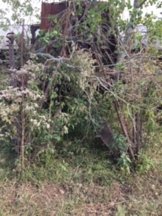

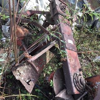

Post Options Post Options   Thanks (0) Thanks(0)   Quote lowell66dart Quote  Post ReplyReply Direct Link To This Post Posted: 04 Nov 2019 at 7:47pm

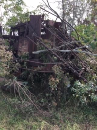

Thomson cane cutter at the same location.

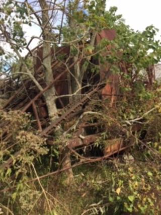

Post Options Post Options   Thanks (0) Thanks(0)   Quote lowell66dart Quote  Post ReplyReply Direct Link To This Post Posted: 04 Nov 2019 at 7:51pm

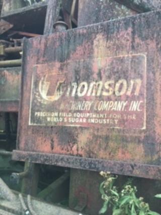

Thomson ditcher. Note the later model logo.

Post Options Post Options   Thanks (0) Thanks(0)   Quote Richardmo Quote  Post ReplyReply Direct Link To This Post Posted: 04 Nov 2019 at 9:31pm
That must be a cane cutter
