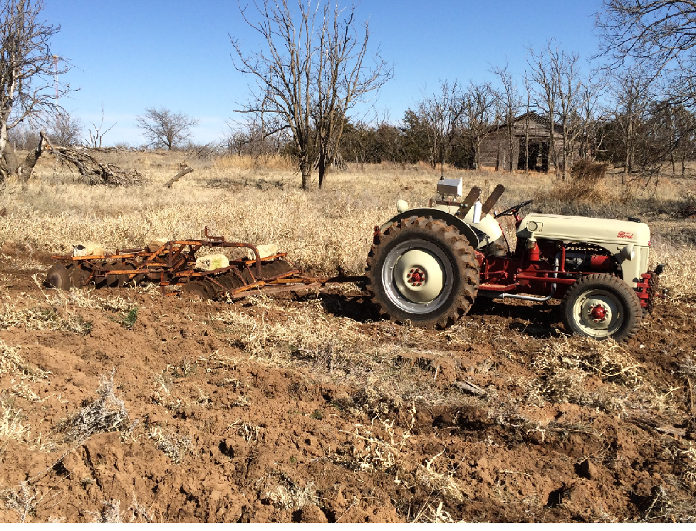

Haha, alright. Here's the reason I asked...I have an Allis No. 9 tandem drag disc I use for working deer plots, and the area is really sandy. I've used the 8N to pull it, because it's my biggest tractor, but it struggles in this ground. Here's a photo from February.
As you can see, the disc penetrates really deep. Granted, there are weights on it, but after trying to make 1 pass, I took them off. They only weighed about 50 lbs each. Even without them, the disc still goes up to the gang axles in the soil. The tractor doesn't struggle too hard going straight, but the problem comes when turning. I've thought about getting a swinging drawbar for it, but I don't know if that will make enough difference to justify still using the 8N, or whether I need more weight/horses from a W series tractor. Right now, it tends to lug down and spin quite a bit when turning if the gangs are set very aggressive.
I know, I know, it's a Ford, but I'm trying to work with what I've got.

Looks to me like another reason to get ya a WD/WD45....

I'm kinda thinking so too, Michael. I like the looks of the unstyled WC, but I'm wondering if it struggles as well in this soft ground if a swinging drawbar would help it out some. I may have to borrow a WC from a friend and try it out first.

straighten the gangs out on the disk more.
Points: 5191
Post Options Post Options   Thanks (0) Thanks(0)   Quote PaulB Quote  Post ReplyReply Direct Link To This Post Posted: 27 Aug 2018 at 2:06am
That’s what you have to do with a Ferd, lighten the load😺

Even with a WC and the disc buried like without a swinging drawbar. The leverage sticking out straight behind the rear tires is going to make the tractor want to go straight rather than turn. It is like trying to pull the tractor sideways from the drawbar. The front will want to plow and soft rear tire will want to roll over and start to loose traction on the outside tire. Then both loose traction as they tend to dig in and take more power.

I agree a swinging drawbar will lighten the load but I think they are hard on the bolts that hold the draw bar bracket.    Time to move up to a WD or WD45 or something bigger than Gramps Ford.

The rear gang is already straight and the fronts are in the notch just after straight. Kinda sad, really!

Thanks, Jay. Yes, I try to follow a pattern similar to that, as it's the only way I can turn at all. The one thing that helps most is driving out of the plowed ground and turning in the tall grass, as that keeps the disc from penetrating as much.
I just need a bigger tractor I guess. Or a 3pt disc. I have a 7' 3pt disc at home I use, and it handles it great. I've just never taken it out to the deer plots because it won't fit on our trailer unless you load it slanted. It's too wide both ways.

As others have pointed out, I don't believe it's the need for a swinging drawbar as much as it is the need for more horsepower and/or weight of the tractor.  No offense intended.  The 8N is an adequate tractor for some jobs but I think you're asking more of it than it can deliver.
I pulled a 10' #10 Allis discs in some sandy loam ground with a WD-45 once upon a time.  As you've probably noted, the disc tends to ridge on the endrows if you turn it too short.  I believe my great-grandfather pulled the same disc with an unstyled WC at one time.

No offense taken, I too believe a bigger tractor is needed. I was just wondering if a swinging drawbar would make enough difference to justify still using the 8N. Guess the only way to know is to try and find out. I believe I know a guy who would let me borrow his WC to give it a trial run before I buy my own.

A wc will pull that like it's not even back there. When I had the disc I could pull 3rd gear with the F-20 on steel.
The family that disc came from were using a C allis in the sandy river bottom

That's pretty impressive! I don't know, gut feeling tells me my B wouldn't pull it, even with 90# in each wheel, and the belly sickle mower on it.
I do like the WC unstyled tractors quite a bit...I may have to bite the bullet someday, although I really probably have too many tractors as it is.

How far from the center of the rear axle is the hitch pin? If you can shorten the hitch and still turn it without hitting the tires it will turn easier.

If I had to drive Ferd like that, I'd look for a 3-pt mounted disk. That would solve all your problems, including turning. Too bad there aren't small farm auctions like there use to be.

Anyone that thinks a swing drawbar is not necessary has never pulled a disc, cultipacker with a spring tooth hooked behind the packer over several thousand acres of ground when a large field would have been 20 acres or less. I used a swing drawbar on my Oliver 1850 with any implements that didn't have wheels that lifted the implement at the ends. Without the swing drawbar it is not only harder on tires it also takes more brake to keep the front from plowing making the turns.
I'm not sure what the numbers are, but it's the correct SAE length from the tip of the PTO to the drawbar hole. So that length plus another couple inches for the PTO length, and that's how far it is.

14 inches, Creston.
