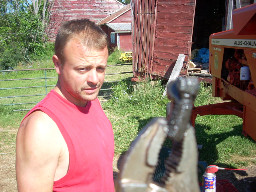

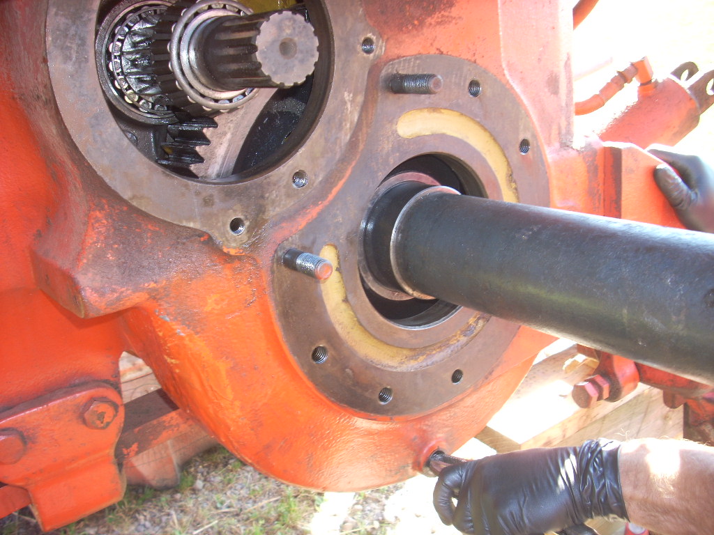

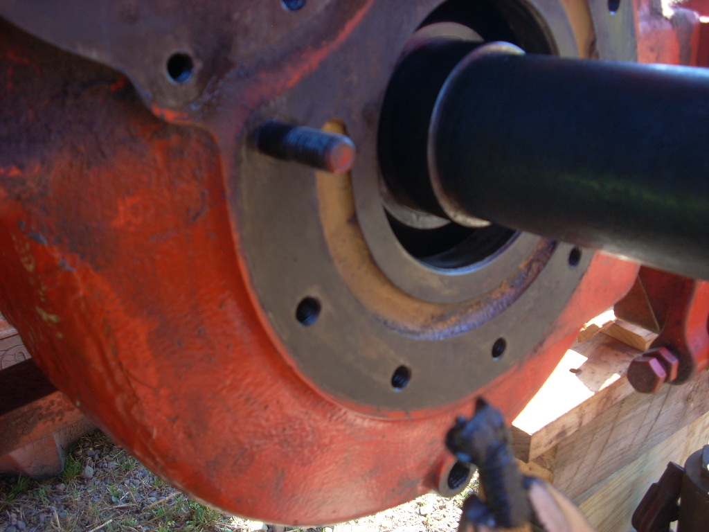

After trying to ferris wheel bolt out both directions unsuccessfully I reconed it was dremel time. Air grinder with 3/8 bit like the Doctor said. I helt a similar bolt to the hole and marked 3 points if the hex head; every other one. We ground the threads back in those 3 places and after vacuuming and flushing like a dentist would do Ian gave her a mighty tug and out she came with him tumbling to the ground! It is indeed one of those grade8 carrier bolts. I have flushed the gears and cavity with diesel. I ran the drain hole plug in all the way tight with my FINGERS! No kidding, the dremel tool kicked but and didnt harm the threads that are left. So now I am off to get bearings, seals, orings, etc.
The reason the ferris wheel wouldnt work is the bolt bept catching and I couldn't turn the ax. We have inspected the bull and pinion and all looks well, some wear but no chips, dings, or broken teeth at all. Thanks to all for suggestions and support and Dr Allis thank you for the tip on wallowing out some threads so the head would clear. When threading in the plug so I could flush the system, it doesn't wiggle or wallow at all. Unbelievable!!!!!!!!!!!!!!!!!!! Capt Dana
