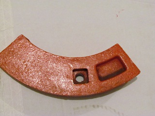

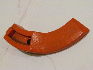

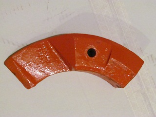

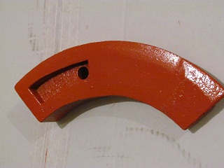

I bought these sway blocks on a farm sale and I'm wondering what tractor/s they come off of? Any educated guesses? The first one has a casting number of AM 5548 and also a FM is stamped under that. The second one has a casting number of AM 5382-1 and RH is stamped under that
Top view of the first one
And the bottom,
Top of the 2nd one notice the tab at the left of the picture
and the bottom
One or both of these could have come from a 210 or 220, but I have no way to cross the casting number I'd like to know a tractor they come from or a part number that the casting number crosses to.

The top one is what I have on my D17IV and should be the same as 170-185.
The bottom one looks to me like a 210-220?

The bottom one will work for a D21 210 AND 220 Niel

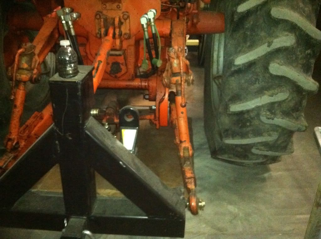

Sway block are mounted on the inside of the lower 3 point arms to keep them from swaying back and forth or take the clearance away on how far the 3 point can move from side to side when hooked up to a 3 point implement.  Some blocks mount on the arms or the drawbar hitch housing sides or both.

The painted orange piece is a sway block in use on a series IV factory 3pt.
The one in the picture should be the same as the very top picture.

Learn something new everyday and I really appreciate you going the extra mile to post the picture and show me.  As usual a picture is worth a 1000 words.  You're a good man Travis.

Travis, isn't that a little overkill on the drink holder?  Oh, I see now, it's a cover for the hitch ball!  LOL
