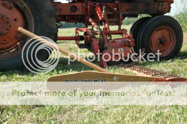

If any one is looking for quality swathboards, Brad in Iowa makes exact reproductions that are spot on accurate and includes all the hardware.  Here is a picture of one of his swathboards on my 82S mower.  His number is 712 483 2577
That swathboard looks as good as my NOS board.
