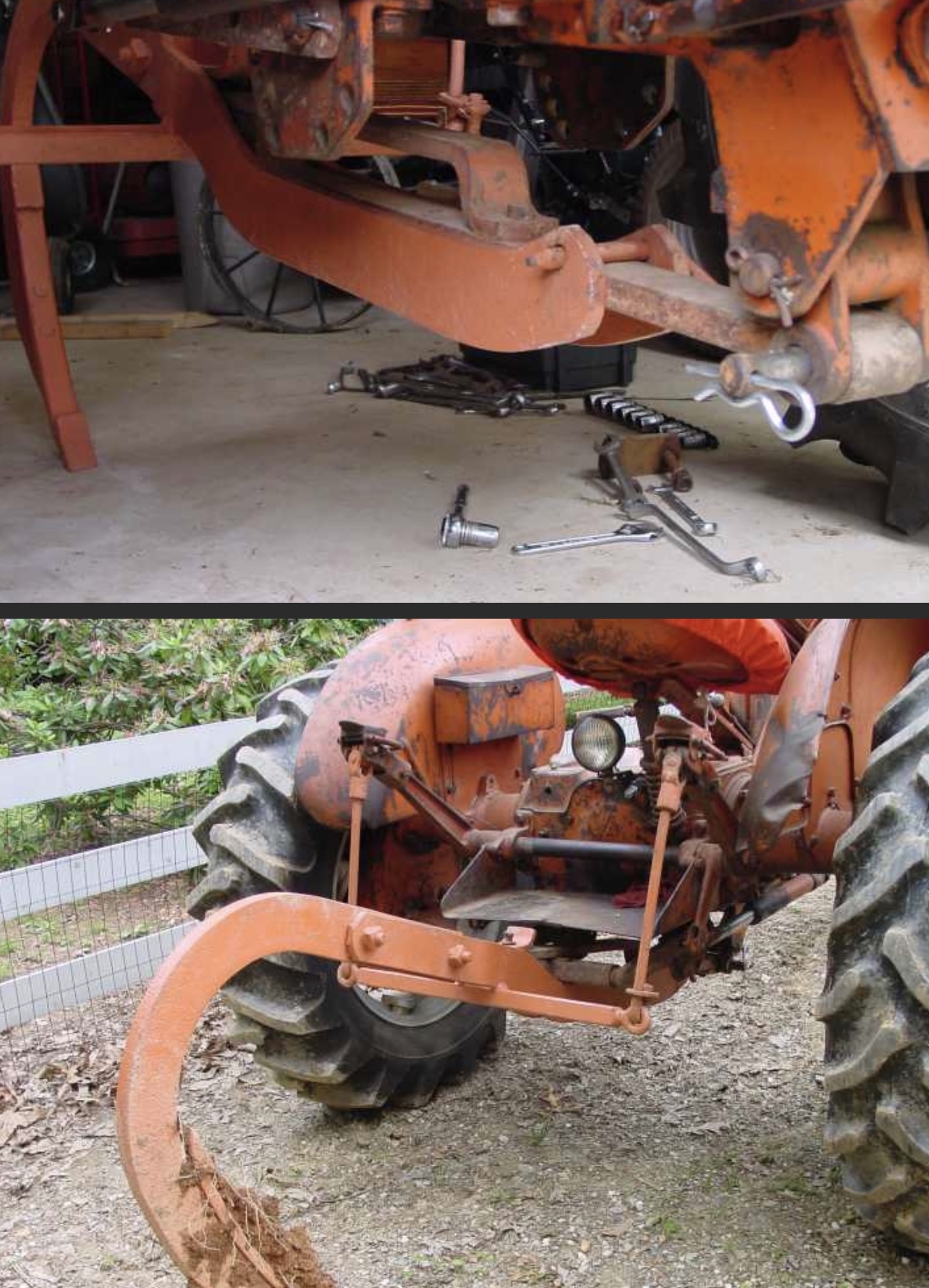

Will this fit on a WD45 that has the snap coupler hitch with the bell for the drawbar.

No, that is for WD pin style hitch!

Since you use the existing drawbar it doesn’t fit both.

I think it should.  Have a similar one that was used once or twice on a wd45 w/o issues.  Probably wrong here, and don't have a book for one, but wouldn't you take the bail off to use it?

Yea I can’t find any info on this model SS. There’s one for sale by me but I’m not sure it will fit. I haven’t been able to find the newer style with the straight shank and snap coupler.

Anyone else have any experience with this SS on a snap coupler draw bar.

On a non-snap coupler drawbar, the bail never falls off the tractor. You pull the two quick pins and it floats up and down. On the snap-coupler drawbar set-up, the bail has slots on the upper ends. So, when you pull the bail quick pins, it falls off the tractor.

Ok so I think what is called the bale is the U shaped piece that adjusts the draw bar up and down on a snap coupler tractor. So if I’m understanding this correctly on a pin hitch you pull the pins and the draw bar moves up and down with the SS which isn’t possible on the snap coupler tractor because of the slots. Am I understanding this right.

My wd disc plow hooks up this way too

And you got it right

also remove your PTO shaft
