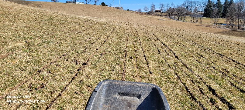

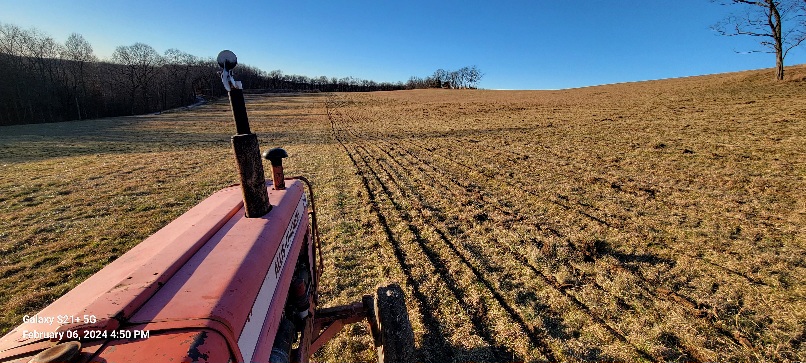

First test field.
Have limed this field to 6.5
Firtilized moderately.
But no significant production over the non improved fields on each side of it.

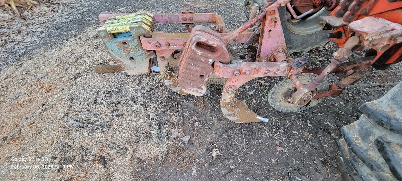

Not ready to plow this field so I thought maybe a sub soil treatment would help loosen the soil and let the top dressed nutrients get to the roots.
It's a test, so we will see.

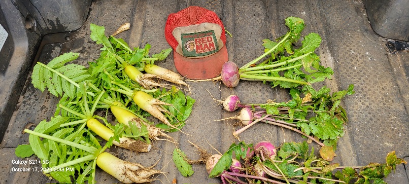

I have only had radish and Turnip production on tilled or burned down fields.
Tried planting no-till radishes in established grass/hay fields for the reason stated above but had zero production. I even cut one section of the field 5 days after planting so as to give radishes fighting chance against the established grasses.
My experiments have proven that burn the field down , no till radishes in the fall then "plow or no-till" in the spring.
Works best for me.
