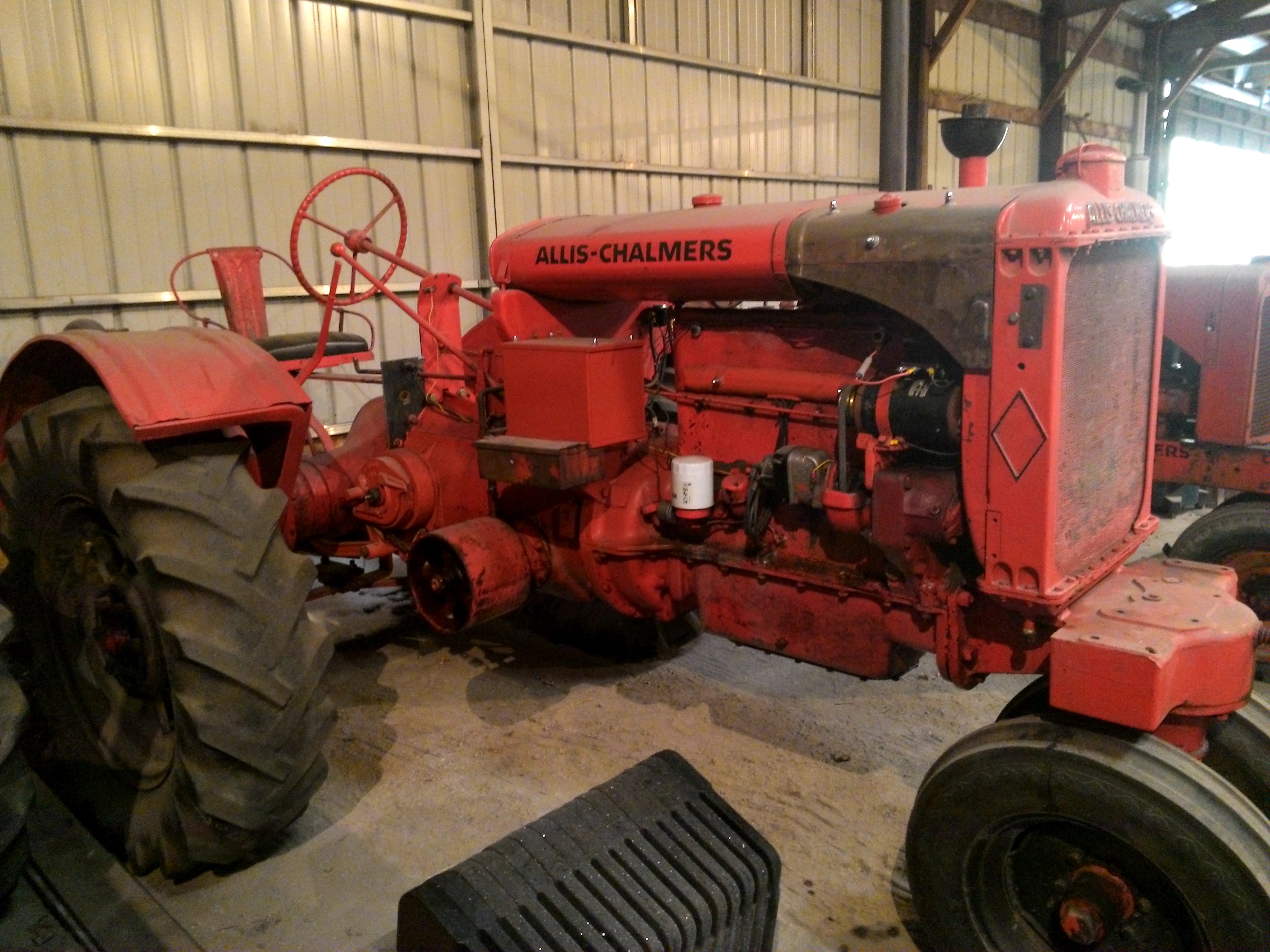

1938 UC and "Cool Hand Luke" in the driver's seat. Luke was a mouse killing MACHINE! He is no longer with us, but his skills in the deadly art of mouse policing will sadly and forever be missed. RIP
As for the steering wheel, the UC had a center hub that was only used on the UC.
