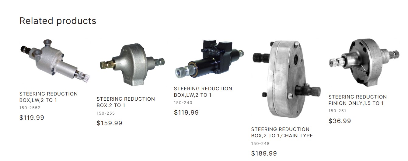

maybe similar to these ? ... they still sell similar...

.  the one one on the far right in your post is the closest in appearance.  It must be a   reduction deal.  Thanks Steve!!!!!!!!

Yes, it was a planetary reduction in the steering wheel hub... and it was a rather universal accessory.
It's not a novel concept ... IF you look at the steering column of my '24 Ford TT truck, you'll notice that there's no gearbox at the steering arm at the bottom... just the drag link to the steering linkage... but when you move the steering wheel 180 degrees, the arm only moves about 18 degrees.  The top of the column has an interesting flare to it, directly under the steering wheel, and that's because there's a planetary gear hiding under that steering wheel hub.
