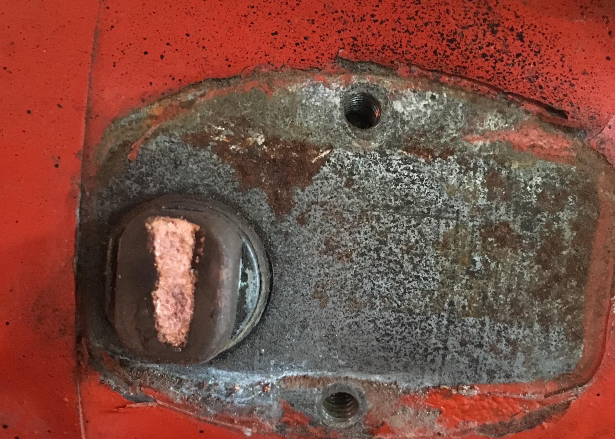

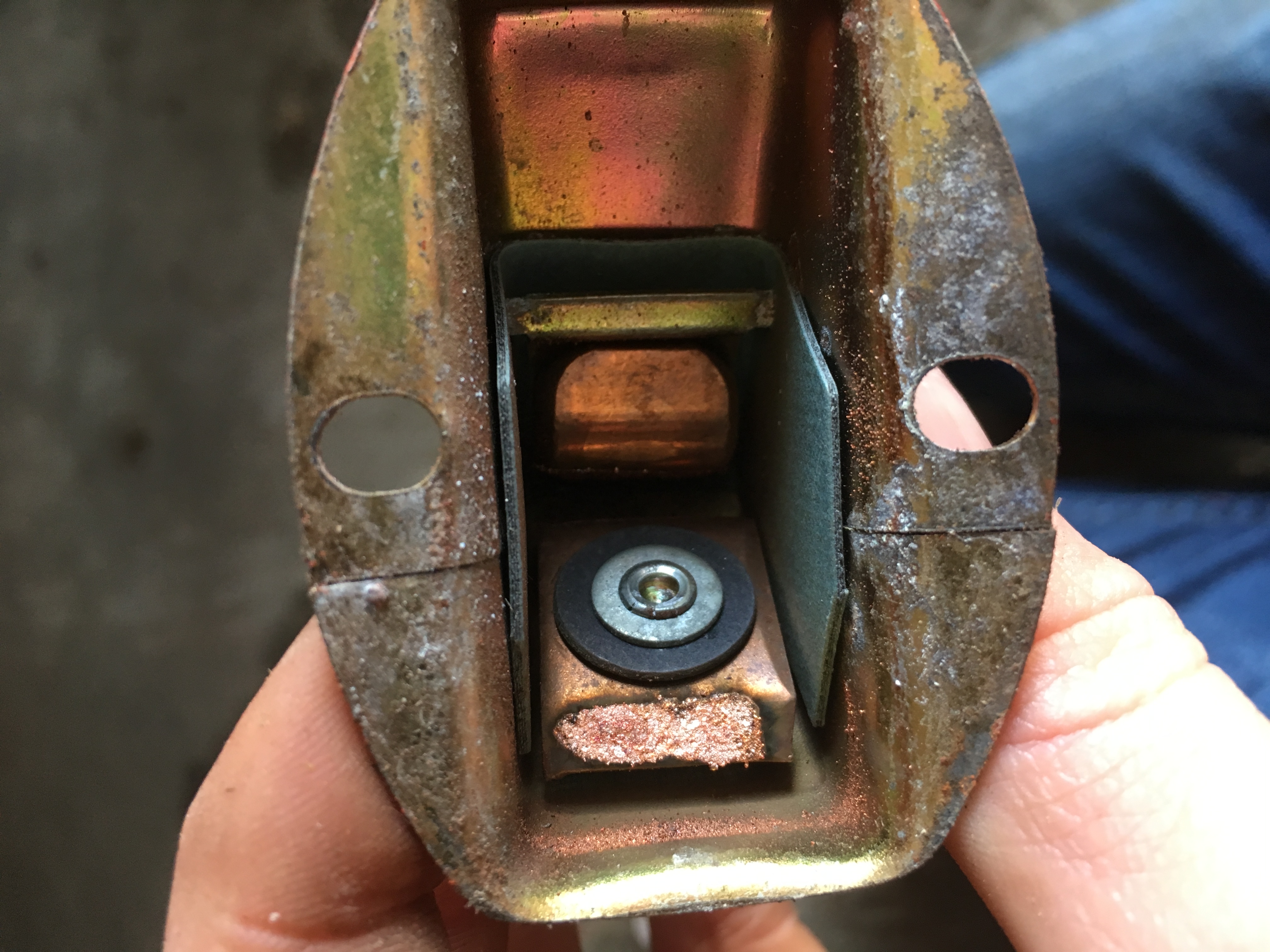

Post Options Post Options   Thanks (0) Thanks(0)   Quote Allis Wd45 Quote  Post ReplyReply Direct Link To This Post Posted: 27 May 2018 at 3:29pm
This is what the switch looks like is there a problem here?
Points: 53535
Post Options Post Options   Thanks (0) Thanks(0)   Quote DiyDave Quote  Post ReplyReply Direct Link To This Post Posted: 27 May 2018 at 5:26pm
Ya think?  I say yes!
At the bare minimum, the contact on the starter needs a good filing, get it down to clean copper, and put a new switch on, or upgrade, as steve says...Wink

Could this have anything to do with using a 6v starter on a 12v system?
Points: 18923
Post Options Post Options   Thanks (0) Thanks(0)   Quote Ted J Quote  Post ReplyReply Direct Link To This Post Posted: 27 May 2018 at 7:47pm
No, actually it is easier on the switch.  But you need to clean that one up REALLY GOOD, or get a NEW one.  You file the opposing pieces so that they can make TOTAL contact against each other when you pull the rod.  You can use a piece of copying paper between the switch pieces to see how much you need to file and how good they fit against each other.  Clear as mud??
