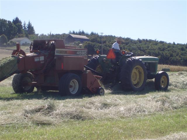

  i own one now and have owned an inline for many years and i love it.  the good the bales fall in your old windrow so no rolling bales.  two.  never a bent bale just keep the hay in the header .  very wide header and no folding the tongue up to go thru a gate or down the road.  don't care for unplugging it on my knees and boy it packs it in the prechamber. here is a photo of my buddy helping bale some teff hay very short and very fine. and i do get a kink in my neck from looking straight back.   sorry for showing green  paint.
