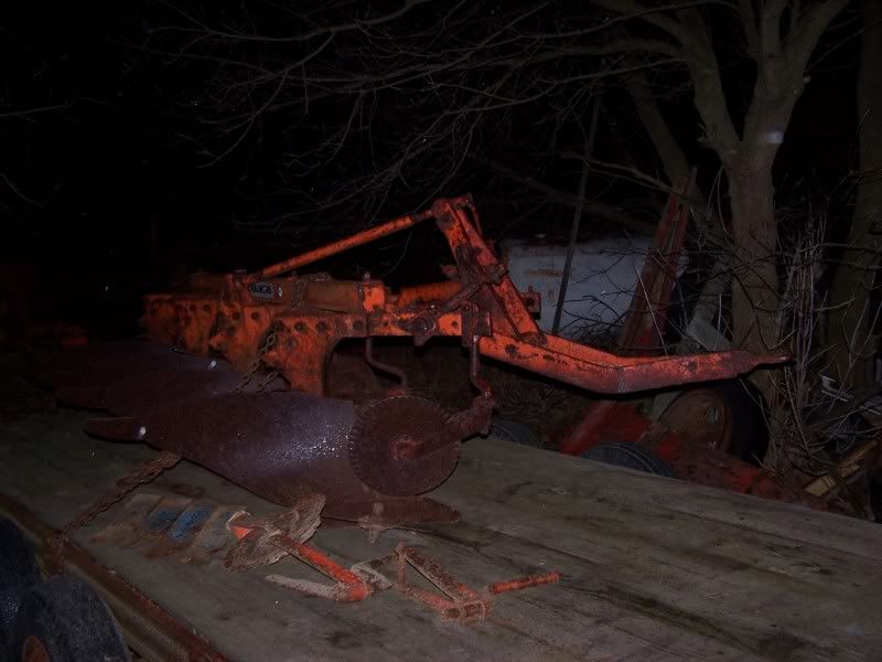

Post Options Post Options   Thanks (0) Thanks(0)   Quote Don(MI) Quote  Post ReplyReply Direct Link To This Post Posted: 15 Dec 2011 at 7:26pm
Here is a picture of her tonight, Think I have it bought. And something else orange (Not sayin til its home).
I guess this is a #84 with trips, 5 extra points.
Edited by Don(MI) - 15 Dec 2011 at 7:27pm

Post Options Post Options   Thanks (0) Thanks(0)   Quote Auntwayne Quote  Post ReplyReply Direct Link To This Post Posted: 15 Dec 2011 at 7:37pm
      Is it another Lab ???
Don(MI) View Drop Down
Points: 3885
Post Options Post Options   Thanks (0) Thanks(0)   Quote Don(MI) Quote  Post ReplyReply Direct Link To This Post Posted: 15 Dec 2011 at 8:20pm
nope, its orange paint!! And a good one too!
