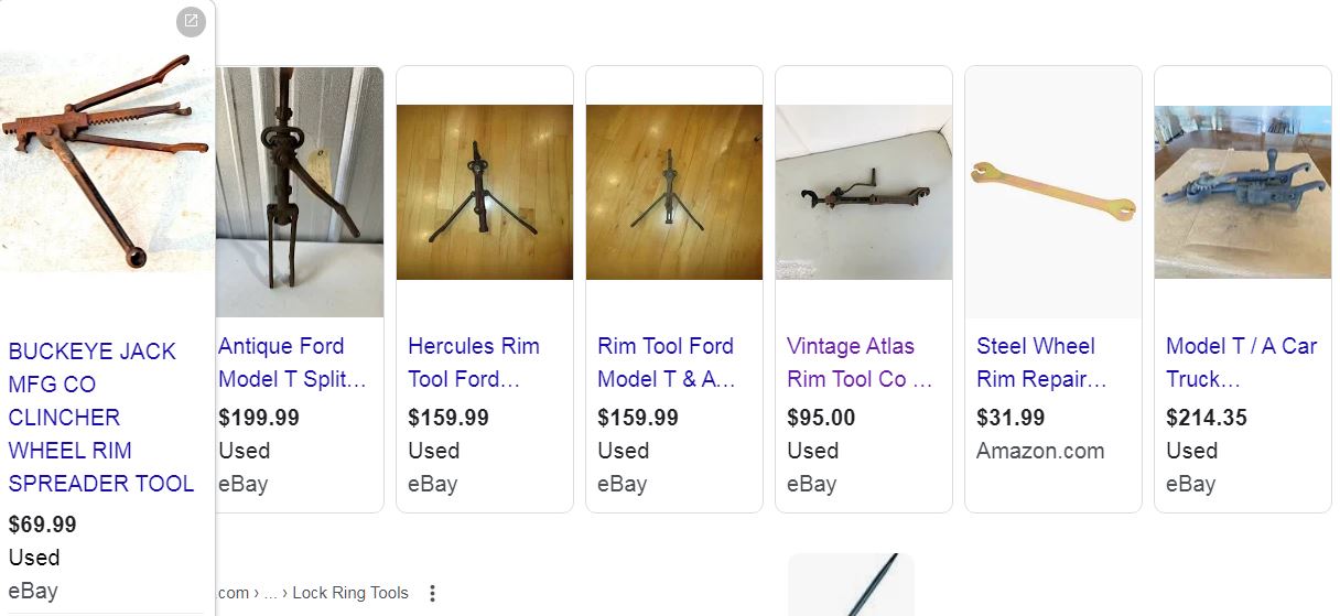

https://www.ebay.com/itm/176139529850?
Edited by steve(ill) - 07 Feb 2024 at 9:13pm
Points: 90597
Post Options Post Options   Thanks (0) Thanks(0)   Quote steve(ill) Quote  Post ReplyReply Direct Link To This Post Posted: 04 Feb 2024 at 10:06pm
there seems to be a few things on e-bay that might work... Personally , i dont have a clue how they work...

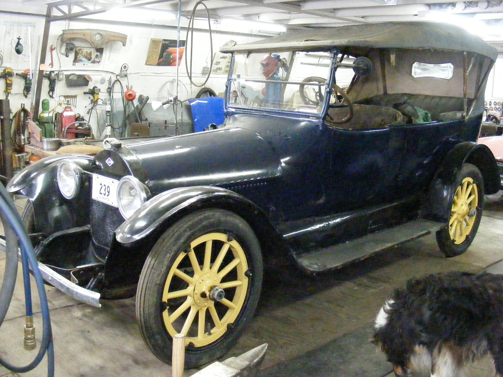

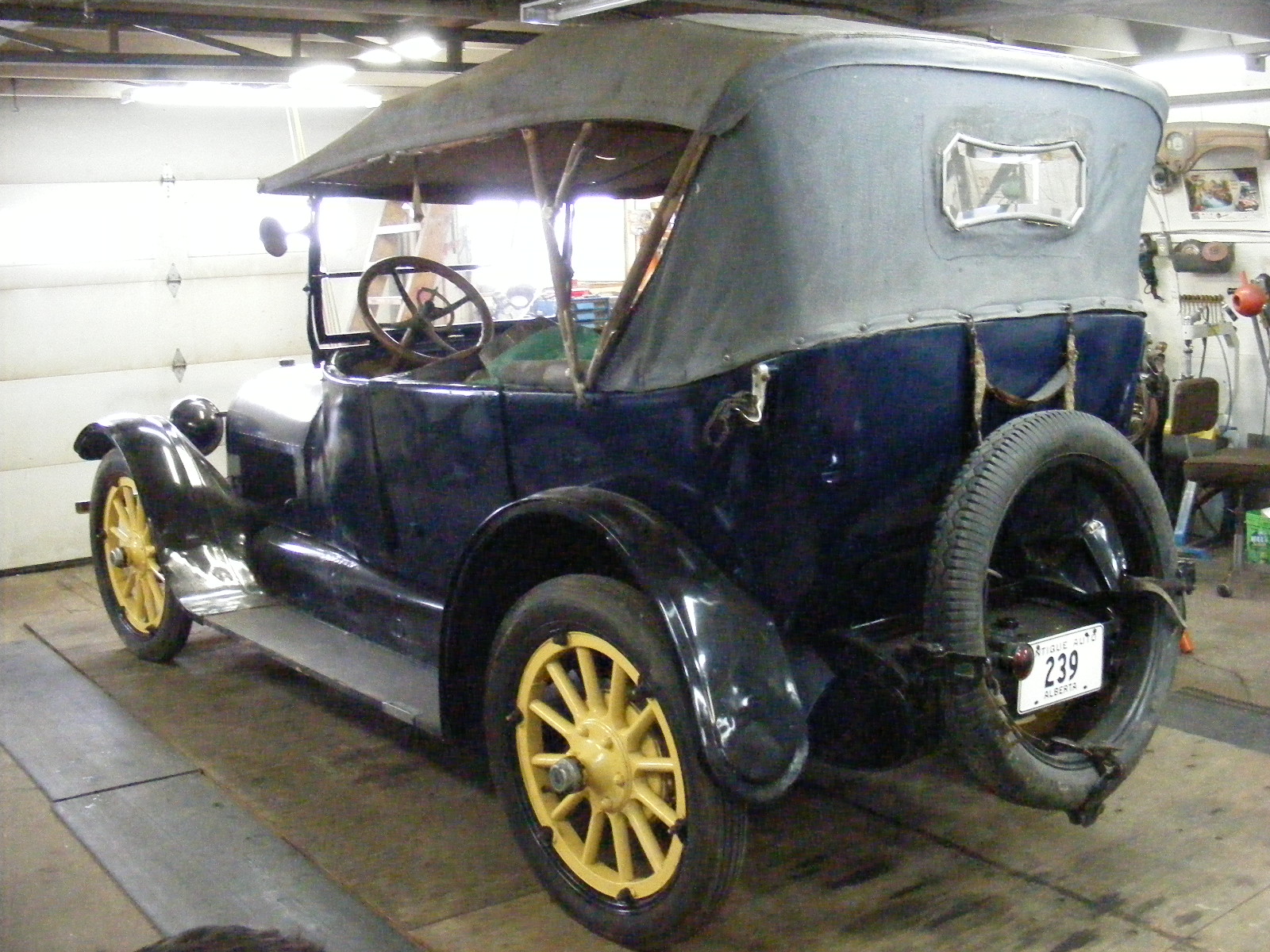

Lou.  The split rims for antique cars come in many varieties, depending on the rim manufacturer. Some are the same style as a truck rim with an outer ring and a lock ring. Others are split across the rim and take a special tool to lever one part of the rim over the other to contract it so it can be removed from the tire.
I mess around with some antique cars and sometimes have to make a tool if none can be found.  I hope I don't have to do the ones on the car that just came into the shop today!!
Here is a picture or two.  A 1918 Mclaughlin Buick.

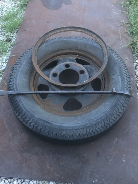

This is the tire tool Dad coveted, I never understood why until I started changing tires on the 35.  The curve and round piece are just right to break down the rings.  Mine are not split but solid, so you have to find the deeper area to hold down at and put another iron in the opposite side to pop it off.
JW, my days of wrestling those big tires are over! LOL Last tire I changed was on the WD, couple of years ago, and I swore never again! it was an all day battle, I have several tire irons, including one such as you show here.
