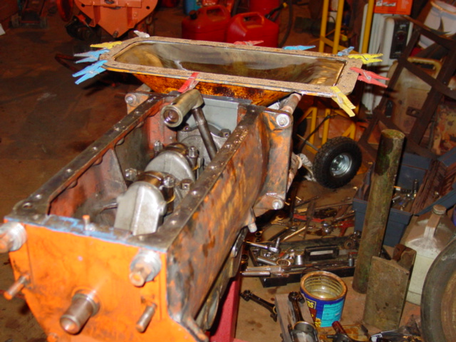

Butch you are 100% correct. My first rebuilds of these engines were front end leakers and I learned to clean and seal with silicone between the bottom of the bottom of the front cover and block as can be seen in this picture.

  Dick L Seeing your picture of an oil pan reminds me of what dad used to do.He used sewing  thread and tied the gasket on .Can leave thread on if you want it will press in gasket.
An old (now deceased) neighbor mechanic used fish line. I took apart an engine that he overhauled and the fish line was still on some of the gaskets.
I used string years before I ever thought of taking pictures and using silicone. Close pins are much quicker and easier for me.
