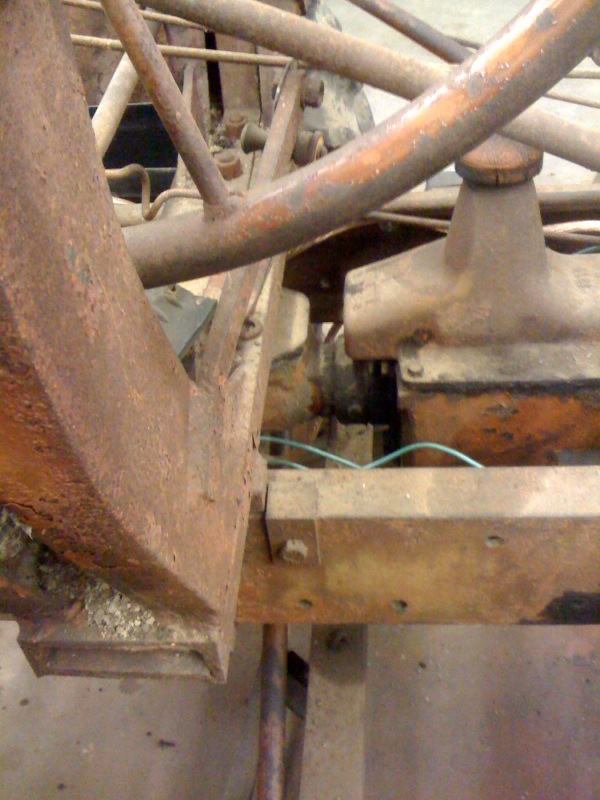

Please be patient. This is my first attempt to upload a picture. My Speed Patrol, when the blade is down and level the arms that raise and lower the blade touch the fenders. If one end of the blade is exteneded further (like on a slight grade or crowned road)the arms really hit the fenders. Is this common? Could someone measure theirs Speed Patrol. The easiest measurement that I can see, if measuring from the shifter tower to the channel frame of the lift assembly. Probably did not explain that correctly, but here is a picture. Let me know

Wow, I did it!

Boomer  !!  On my patrol there  is 1.75 "    Tony

One of mine is 2-1/4 and the other is 2-3/4. Must not be a perfect science to it?

Ours is 2 5/8ths.
