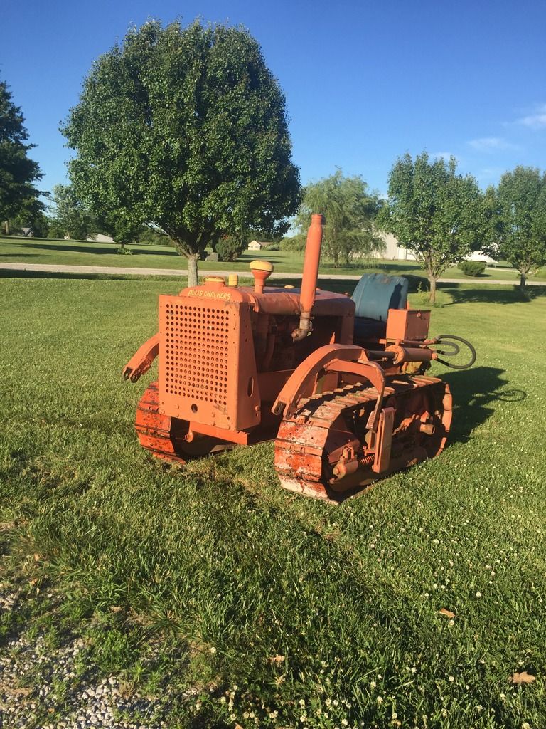

Was on a roll with the CA today as we have a show coming up this weekend so I decided to take a stab at the crawler. Replaced the missing gasket in the carburetor last fall but the battery didn't have enough umph to roll it over.   So today I cleaned 1/4 inch of varnish out of the sediment bowl, dug around in a drawer for the least misshapen sediment bowl gasket, used the battery out of Ford and after cranking for less than a minute we're out playing in the yard.  Couldn't remember how to get it up out of first in to reverse so it's "Yard Art" tonight.

Awesome. will you be bringin that to Republic this year? I hope to have ours running by then and have it up there.

Move the shifter slightly to the left and sort of rotate to the right and pull back (shifter lock is prob engaged) in to neutral then all way to the left and forward.

I still don't have the right clutch repaired so reverse is important.
