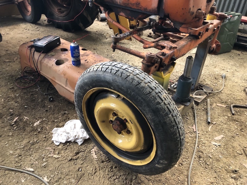

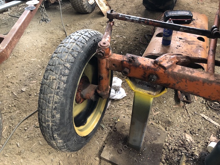

I modified a space saver wheel off a honda car it has the same hole pattern as the ca , I just bored the centre hole out a bit and moved the centre of the rim in a bit and re welded it , they are a cheap way of replacing rust rims and the tyres work well

Since you cut the centers loose, could you just cut the center out of your old rim and welded it into the doughnut rim and have a similar look of original rim?

There is some wheel like that one that will fit with no modification except cut the center
just a little,have a D10 with them on it bought it that way.

my centres  were damaged and there are not many Allis tractors around here anymore , the wheel weights fit in as well

I put Two of them on Dads "B". Then I bought tires and rims at the GOTO in indiana a few years ago but he likes these :) maybe someday we will get the correct ones bolted on :)

Sure hope the tire was offa the rim, when you welded on it, if not, there may be a big BOOM, in medical bills...Wink

I 'think' full size Chevy wagon rims will bolt right on, maybe 'old' GMC pickups ? 5 x 4.75 pattern ??

I have a B here that I put space savers on, no mod what so ever, not sure now, but I think they were GM

Keep an eye on the lug nuts. Those rims should have a metric bolt pattern.

I just bought new rim blanks and riveted them on the old wheel centers to make it look like the  original ones.

I put a set of them on a Farmall A.  Used the rims that were on there.  Never had a problem so I guess they fit the narrower rim.  Sure made it better cutting grass.
