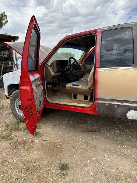

 A bit of an update on the One Ton,,,I'm getting her ready to paint the door jambs and hood edges hopefully TODAY,,,,!!
 THe guy that painted "Ole Red" for me is who is going to paint the trk on a "Trading Work" agreement and is how I like to do my work outs,,,,great for all concerned too,,,!!
 I will paint the jambs etc and than take the trk to him and leave it for painting the body in his shop,,,,,,can't wait,,,,,

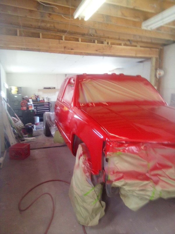

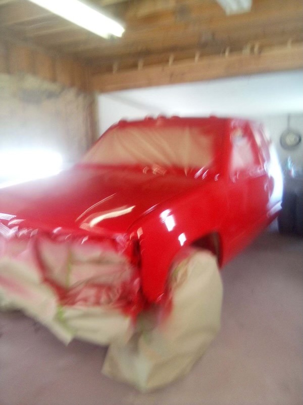

  OK, I feel some like ole Shameless "might" be breathlessly waiting on a progress report on the old One Ton I been working on,,,,,, My friend, who also painted "Ole Red" has done a number on the 1988 GMC One Ton ,,,,and from where I'm sitting,,,it looks many wonderfuls,,,,!!!! The paint is Poly-urethane in Porsche Red that I had bought for another of my Forgotten projects that must of fallen by the way side,,,,Ya'll know how us senior folks tend to be quite forgettful at times,,,,LOLLOL
 Anyway,,,,the painter got her done this past weekend and it sure is pretty!!!Clap
