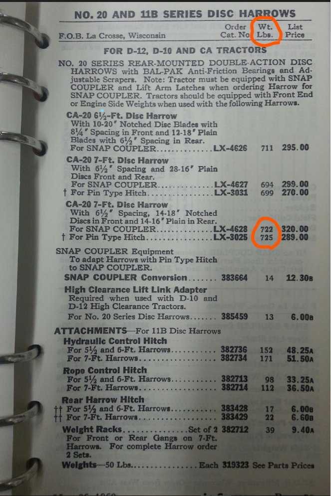

Does anyone know bought how much these weigh.

This will get you close on what the disc weighs....
