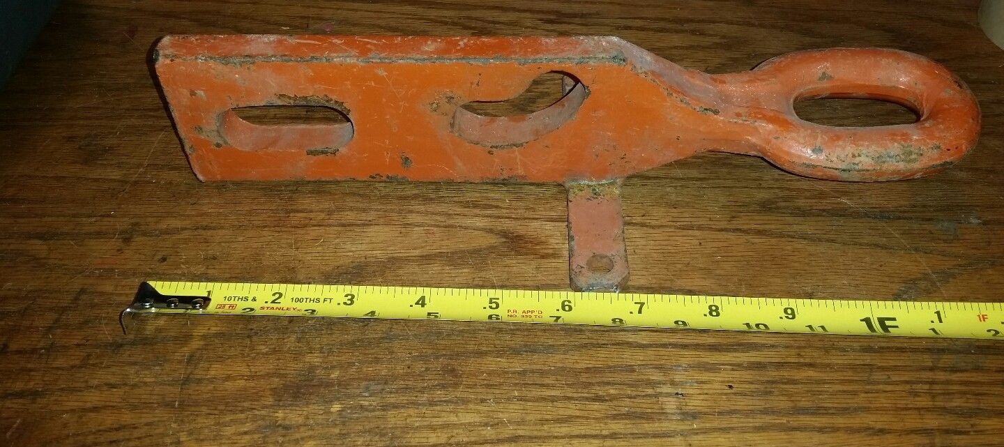

Usually you can find one on eBay.  One is listed down, but a little high at $34.95.
Don't know what that's offa, but it is similar to a plow.  most plow eyes don't have slots, or that little flat bar, welded on.  also, there are different length eyes, depending on the final length wanted. Post a picture of the plow and we can ID what you need...

Post Options Post Options   Thanks (0) Thanks(0)   Quote IBWD MIke Quote  Post ReplyReply Direct Link To This Post Posted: 30 Jan 2019 at 2:44pm
It would be interesting to know what that originally came on. Has a degree of adjust-ability to it. Not necessary for a plow, maybe why the high asking price?
I have one that is offset, never figured out what it was originally for.

Post Options Post Options   Thanks (0) Thanks(0)   Quote Ted J Quote  Post ReplyReply Direct Link To This Post Posted: 30 Jan 2019 at 7:57pm
That is interesting, I don't ever remember seeing one like that.  Somebody out here in Allis land knows what this one is for.
Yes, the plow one just has the two holes neither is slotted.
