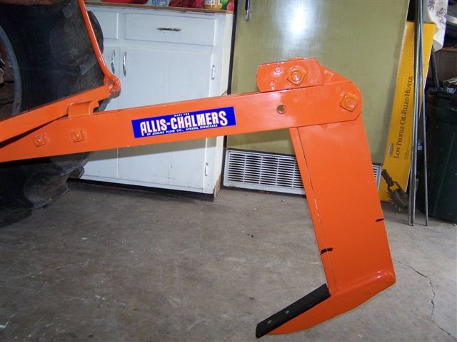

Here's a picture. Thanks.

Post Options Post Options   Thanks (0) Thanks(0)   Quote SteveM C/IL Quote  Post ReplyReply Direct Link To This Post Posted: 24 Oct 2016 at 11:40pm
If yours is like the one in pic,that screw needs shortened up to tilt the point down

I think this is a #3.  I got it from bryani289swmi.  I still love it Bryan!

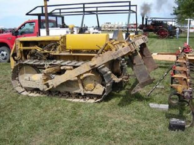

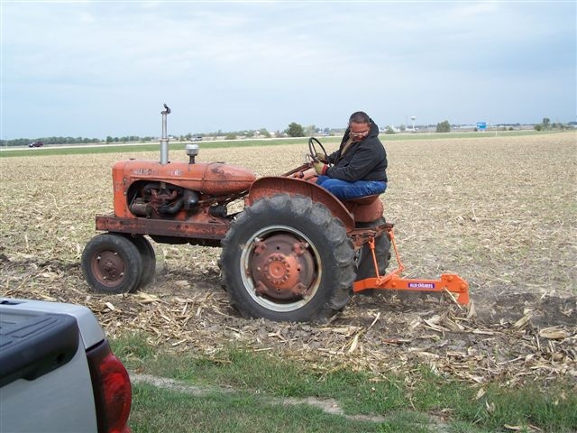

They will run deep if set right, here's Dave on his D17 at last year's plow day.
Michael Crowe on his WD45 K pulling a pin hitch unit.
I had my sub soiler behind Jerry's D14 running just as deep as the one's behind the bigger tractors, but I can't find a shot of him working it, sorry Jerry.

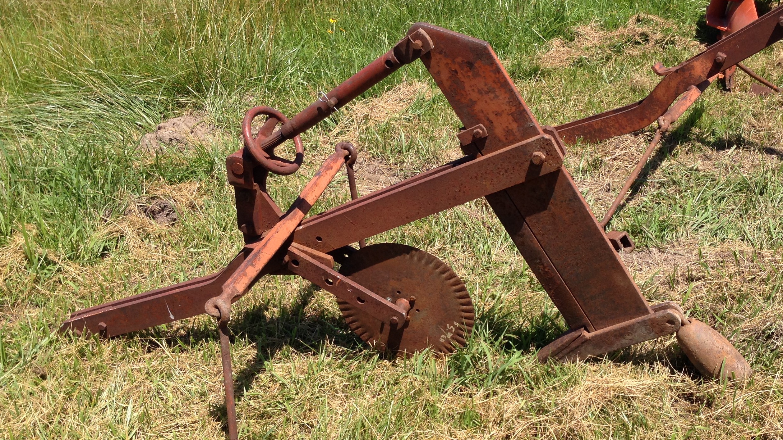

How weird this whole thing is. Brian F(IL) has the subsoiler I sold him. The one in the picture I posted first is of one I bought from Michael Crowe. I just got done using a different one tonight to subsoil up a couple acres, I bought that one at an auction in Indiana! I was subsoiling up a low spot in a bean field and didn't need the trash cutter as in the one I bought from Michael. This spring I hope to use the one pictured below, after I get it home. Thanks.

In the first picture up above, what is the part attached on the back side of the point for? Looks like it would be to open up a tunnel down there!
Edited by littlemarv - 29 Oct 2016 at 5:37am
The mechanic always wins.
Chris (swIA) View Drop Down
Location: Prescott, IA
Points: 319
Post Options Post Options   Thanks (0) Thanks(0)   Quote Chris (swIA) Quote  Post ReplyReply Direct Link To This Post Posted: 29 Oct 2016 at 1:15pm
That is a mole that does leave a temporary drainage tube behind the subsoiler.
