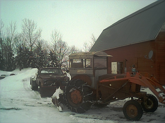

I have a snap coupler blower don't know who made it in my tree row under several feet of snow. I also have an erskine v type rotary plow pulls behind the WD 45 works great picture of pull blower below. for keeping the road clean blows the snow way out in the trees. If you can drive through it you can blow it. When the drifts get over 3' you can't drive through it any more. Even with wheel wieghts and tire chains. Right now I n
Have a 7 ft IH back up blower on my WD45, the back up blower works great for opening up impassable drifts and blowing back the road edges. All the wieght is on the back tires with chains on just keep backing till you can't move any more lift the blower and drive out. I had a front mount but as soon as you couldn't move foward any more you just got out and get the wife to pull your stuck tractor out.

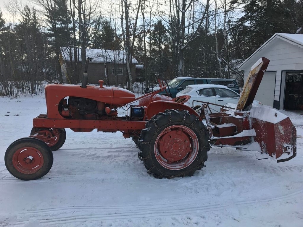

uploads/14031/WD_blower_Medium.jpg
To make it easier to find a blower it is not hard to put a basic 3 point on a WD. I just have the arms bolted to my hitch mounts and connect the top link to lift arm bar. Not perfect but works pretty good. Just have to chain the lift arms to the hitch so when the blower is down they are tight so it doesn't flop side to side. I have a 7 foot blower right now which is too much. Lots of time on the hand clutch feeding it into the bank and when you pick it up you pretty much steer with brakes! I am trading my dad for a 6 foot since he has the big farm tractors to run the 7 footer and that is a nice size. We always used the 6 foot on the farm with the old family WD that is there. It is a nice size and nice to have the 3 point for any other implement you come across and want to use!

The one in this pic looks a lot like an ARPS. You can reverse the frame and blower, and turn it around 180º to make it a rear facing back up type plow.  These need a good coat of paint,and some veg oil, to keep dry snow from sticking. in wet stuff they are practically useless...WinkWink

Nope its an Erskine Champion rotary plow made in Erskine Mn about 50 miles from here. still has the manufactors tag on it. its a 6' with a right extension wing.  its on a 3 point adapter and not  reversable.  I dont have any better pictures of it and currently have a IH model 70 two stage blower on my other WD 45  this one just has the snow bucket.  Having the bucket and loader on the same tractor is very unhandy.
