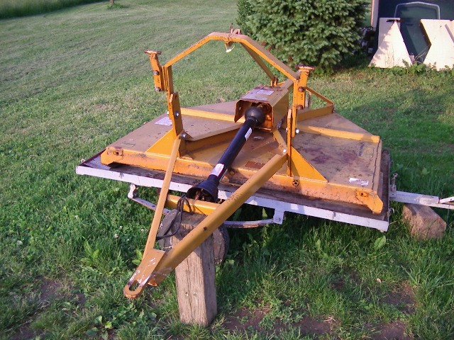

Post Options Post Options   Thanks (0) Thanks(0)   Quote Travis2766 Quote  Post ReplyReply Direct Link To This Post Posted: 20 Jan 2016 at 9:19am
Here's a good picture of a Woods mower when they actually made a factory SC mount, doesn't look very hard to make

Post Options Post Options   Thanks (0) Thanks(0)   Quote Doug-KS Quote  Post ReplyReply Direct Link To This Post Posted: 20 Jan 2016 at 2:34pm
CTucker, I sent you a pm on your hitch.
Travis, I agree, doesn't look to difficult to weld up something. I was curious about adjustments or "tipping" front to back or if I should weld everything stationary. This looks pretty stationary.
