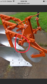

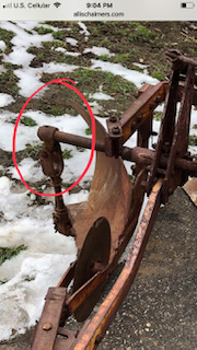

SGTJ View Drop Down
Joined: 15 Apr 2019
Location: La Valle, WI
Points: 106
Post Options Post Options   Thanks (0) Thanks(0)   Quote SGTJ Quote  Post ReplyReply Direct Link To This Post Posted: 24 Apr 2019 at 8:52am
I believe this is what they're talking about when they say "lift Arms".   Not the hydro arms on the tractor, but these extensions with the "U" shape pivots / couplers.
WD , CA
Points: 22861
Post Options Post Options   Thanks (0) Thanks(0)   Quote DrAllis Quote  Post ReplyReply Direct Link To This Post Posted: 24 Apr 2019 at 9:06am
Better described as "lifting links".   The lift arms on the tractor cannot be lowered to the bottom for normal plowing depth because the ground rolls up and down. There would be times the plow wouldn't be in the ground if the front tires of the tractor went over a small hill.
Edited by DrAllis - 24 Apr 2019 at 9:07am
