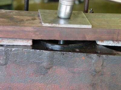

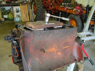

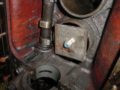

Here's how I got mine out... A piece of allthread, nuts, heavy square plates, a strong board.

The easiest thing to do is just knock them out with a block of wood. I did make a puller similar to the pics posted but it's just as easy to drive them out.

Post Options Post Options   Thanks (0) Thanks(0)   Quote allis6080 Quote  Post ReplyReply Direct Link To This Post Posted: 27 Jan 2012 at 2:01pm
thanks guys for the info and pics i just made one up n got em pulled out. tried the hammer n block of wood but that didnt work very good.
