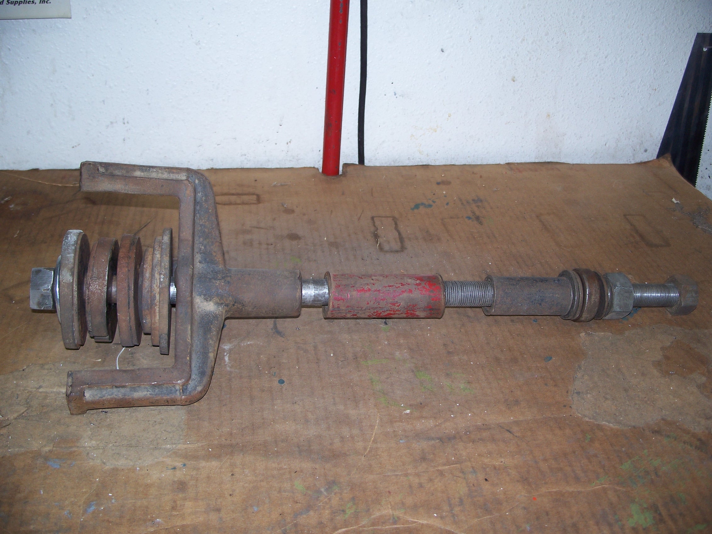

Can someone post what a sleeve puller looks like for a AC7060 670i engine.  Thank you, Jim

Post Options Post Options   Thanks (0) Thanks(0)   Quote LB0442 Quote  Post ReplyReply Direct Link To This Post Posted: 11 Nov 2019 at 1:38pm
I bought this from I guy I worked with back in the 80's.  I have used it a lot, works really well on the dry sleeve motors.  So far all of the end pilots have worked for everything I needed including the allis 426.
