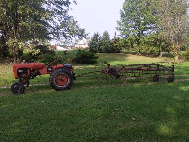

What are you using for a rake? I like to have hay laying flat, spread out about(with a Tedder). There are a few times through the year that I can get hay dry without tedding. I NEVER rake grass hay until dry enough to bale the same day. If you have a rotary rake, it can buy a few hours max of drying. Just my opinion as many have their own process.

Old side delivery and model b

Will that Ted?

I'm not sure.
I've read somewhere that flipping the handle a certain way that it would but I don't see how?

roll bar rake that I saw reversed the direction of the bars so that instead of rolling opposite of the direction of travel to make a windrow it flipped the hay straight back. baled lots of hay in NE OHIO And humidity is more important than temp. Often helped by later in year grass is trying to go dormant and not as lush.

There is a lever. I'll have to read up on them. I've read quite a bit on the dangers of bailing hay when too wet but all those are in reference to alfalfa hay which from what I read is a bit different than orchard grass. I understand mold is mold, but at this point I don't want to completely give up on it since it's going to rain Friday Saturday and Sunday here. They will probably only be about 5 4 ft by 5 ft round bales and if I have to I will unroll all of them before they can grow any mold on our fenced in pasture just so it doesn't go to waste and the cows get to eat it.
It's not perfect by any means but I have been working on replacing the gearbox in this sickle mower and many other components and this looks like the last opportunity to get it cut and share with my cows even if I have to unroll it immediately I will so it's not a complete waste of time and money!

Running a hay rake roll bar in reverse in called Tedding.

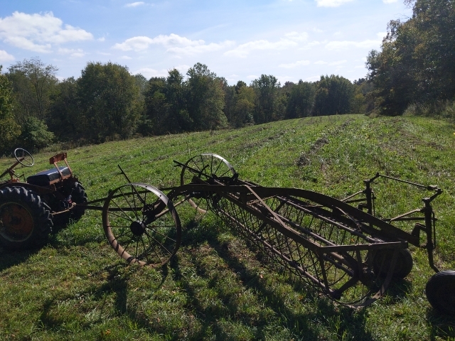

I tried mine in the other position but it seems like it's either lost the ability to run in reverse or never did begin with. When I moved the lever to the other position other than neutral it feels really tight and it seems just the same as in neutral...
I did get it dry enough and in round bales before the storm comes!
