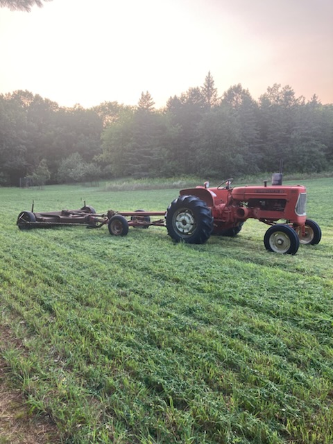

Points: 5463
Post Options Post Options   Thanks (0) Thanks(0)   Quote AC720Man Quote  Post ReplyReply Direct Link To This Post Posted: 05 Jun 2024 at 8:09pm
This is when my 82S was mounted on my WD with the AC conditioner tagging along. A nice compact package that works great. I have not had issues getting parts for either one, but then again I haven’t needed parts often. With the loader on, the 82S wouldn’t be an option for you. Which is a shame because you would love this mower.
