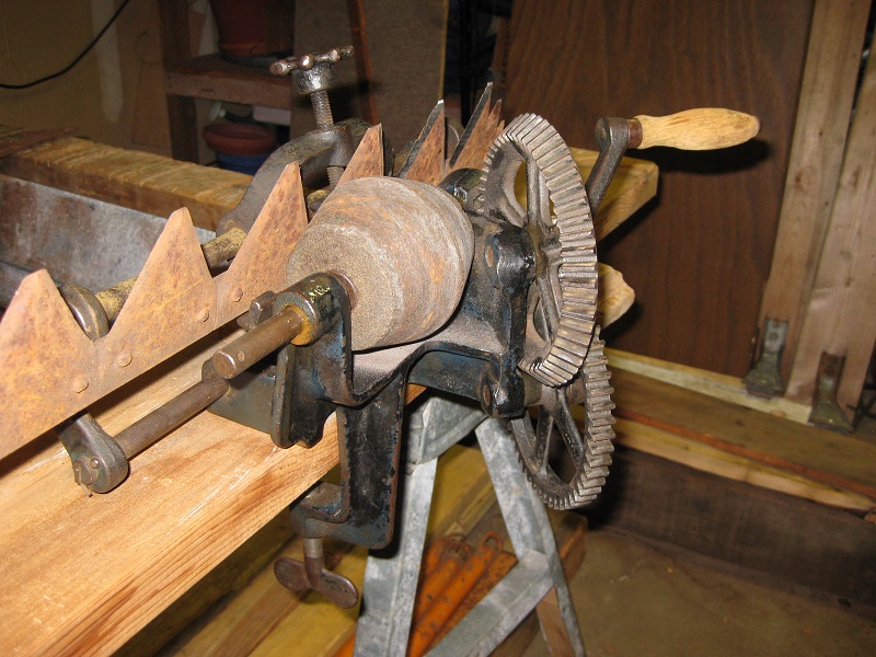

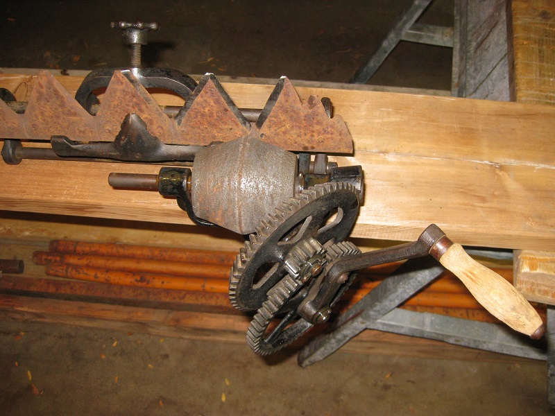

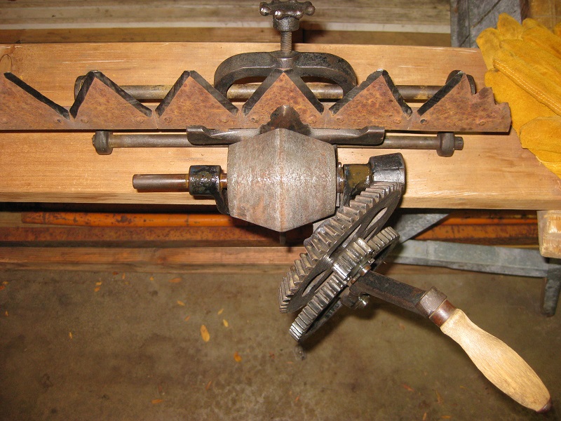

I picked up an old time sickle bar sharpener from the swap meet at the Jordan, MN Threshing Show this summer. Cleaned it up and finally tried it last night in the garage. Got a couple 6' sickle bars off of a B hay mower from a friend. I was surprised how good it worked and the longer I used it I started making better time. There is a rail behind that slides back and forth and the sickle bar clamp also slides independently on that. So with one clamping you can sharpen 10 knife edges before you would have to re-clamp. The clamp tips into the the beveled stone and you can work your way through the whole edge of the knife doing 2 edges at a time. Pretty unique invention with all the gearing prior to electricity. I would still opt for a disc grinder like we used to use for speed factor.

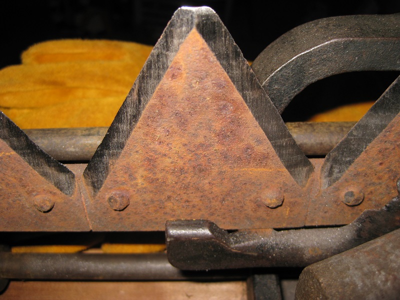

A sharpened section will never cut like it did when new,OK if you're just cutting weeds or pastures to really cut hay you need new sections in top condition.

Handy dandy is what that is and darn cool too.Thumbs Up

Looks like it does a nice job. Never saw one of those.

We had a grinding wheel like that on a shop grinder...I would hold the end of the long end of sickle bar when dad was grinding on the other end, in the middle he pretty much controled the whole thing.

I have one that you put in an electric drill, and like Gary says, if you cut hay or grass, you'll need new sections, but sharpened is o-k for most weeds cutting.

Some of the old ones were made to clamp on the tounge of the horse drawn mowers.

There was one here when I was a kid made to clamp on the steel wheel on the old McCormick horse mower. Thought it was good when some body  let me cut with a sharpened knife,never heard of high binders that would ever buy all new sections on a knife.
Well times have changed how we are cheap now. I have even put all new on once or twice myself by now.

I have to agree, Times have changed, I think these sharpeners used to be common before throw away sections were so cheap.

Years ago we had one like Shameless said. One end had a handle, the other end went in the drill. I remember it did a good job until you got towards the ball end. The steel got thicker and you had to use a hand file.

Looks like your stone is loaded up with debris, you need to get a stone dresser, or stick, to clean it up.  You will be amazed at how much quicker a clean stone works...

We had a stone like that on a simple grinding arbor my dad bought. He mounted it on an old cream separator stand and hooked it up to a salvaged washing machine motor...he thought he was in heaven as he was used to using a carborundum  stone to sharpen them for years. I would just take a 4" angle grinder to them now :-) I remember he always saved a new sickle for cutting 'wild hay' (grass).

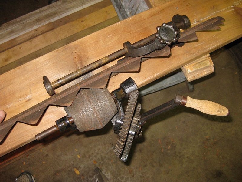

That's an interesting knife located at the end of the bar.
Never seen that shape before.

A split section at the end will keep the grass from clogging the end,amazing how many
mowers I've bought with a regular section on the end.No wonder so many people hate to use sickle bar mowers without one of those sections in short grass the end will constantly
clog.

As far as using  sharpened sections I've noticed the same folks that say sharpened sections work well are the same ones that will say how much better a haybind is than a sickle mower to cut hay.A lot more to a section cutting as it should than just being sharp.
Angle,serration,how it matches up to the guard all gets changed when a section  is
sharpened.

Dad had a Craftsman portable grinder with a flexible shaft and hand-piece.
The motor and stepped pulley parts were on a small frame with 3 casters.
The double angle stone was mounted on the end and was used to sharpen a sickle.
It could also be used with a plain flat stone for general purposes.
