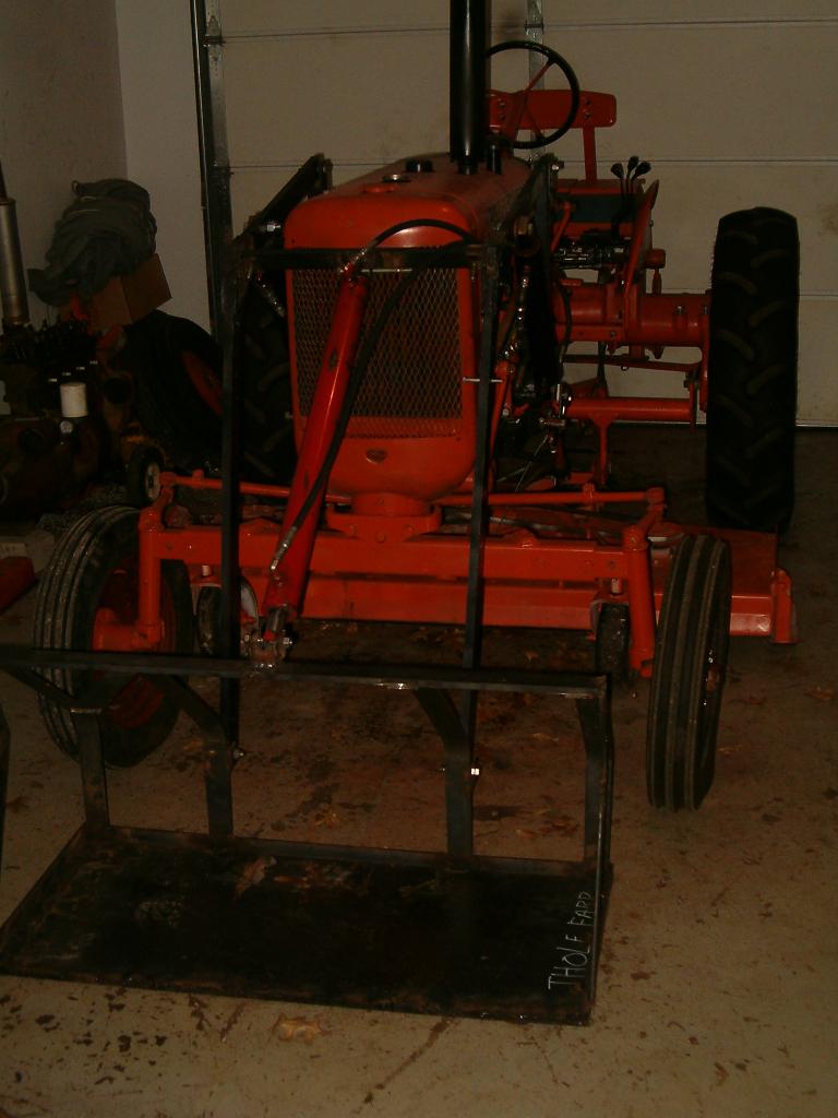

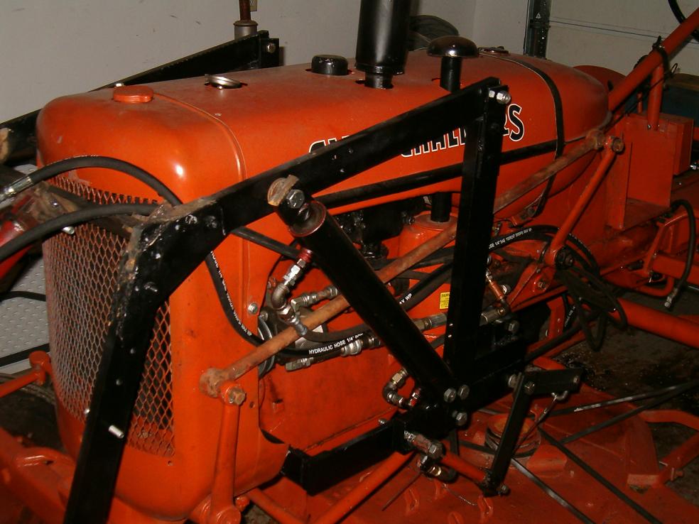

I ended up making my own.  It is unfinished, and very crude, but lifts 400# fine and I can take it off in less than 15 minutes.

What size is the pump and does the belt slip?

Post Options Post Options   Thanks (0) Thanks(0)   Quote Larry in Ill Quote  Post ReplyReply Direct Link To This Post Posted: 16 Oct 2012 at 2:47pm
I think the pump is .31cui and the belt is fine for the smaller loads

Larry,
Where did you get the cylinders? Are they high pressure AC cylinders?

Post Options Post Options   Thanks (0) Thanks(0)   Quote Larry in Ill Quote  Post ReplyReply Direct Link To This Post Posted: 16 Oct 2012 at 7:16pm
I was REALLY lucky on the cylinders.  A company on Ebay was selling a set of 2 x 22 and 2 x 14 3000 psi from what I was told was New Holland equipment.

Post Options Post Options   Thanks (0) Thanks(0)   Quote allischalmerguy Quote  Post ReplyReply Direct Link To This Post Posted: 16 Oct 2012 at 9:05pm
You did a great job Larry on the set up,,, what did you use for a pump?
I like it and see you made the bucket to be hydraulic too. Well done.

Post Options Post Options   Thanks (0) Thanks(0)   Quote Larry in Ill Quote  Post ReplyReply Direct Link To This Post Posted: 17 Oct 2012 at 7:17am
The pump was off ebay, it's a bit slow but good enough for what I'm going to use it for.  Having the mag is rather handy, I can have a full charge for the weekend, start it a dozen are so time and still show 11.5-12 on the the ammeter.
