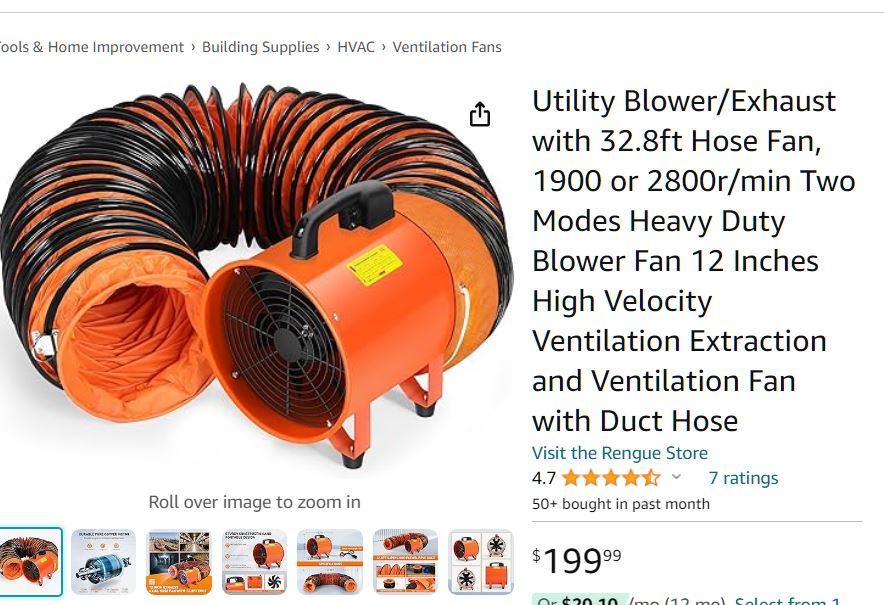

you need 20 TIMES that much air flow.... Get something like this.. You can set the hose real close to the work... or hang a "BIG BAG" type umbrella above you hooked to this hose.
Points: 90826
Post Options Post Options   Thanks (0) Thanks(0)   Quote steve(ill) Quote  Post ReplyReply Direct Link To This Post Posted: 20 May 2024 at 10:26pm
thats what we used in the Weld Shop... You can make an overhead Umbrella out of thin paneling ( 4 sided funnel) or a conduit frame with heavy plastic over it.. etc.
