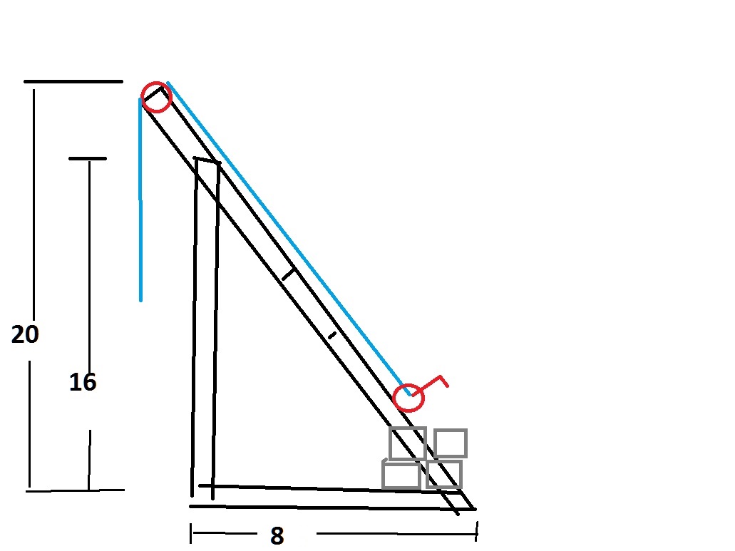

several years ago i put up a barn and had no help available for the rafters.. I took a dozen 2 x 6 boards and bolted them together to make a triangle base  with triangle uprights and a ridge pole... I put a boat winch on it and a few blocks as counter weight if needed... Keep the front "FEET" close to the front of the boom and the rafter will kind of slide up the legs and keep it from spinning.. I would drag the boom around with the B tractor and place it by eye under the rafter location... Set the rafter under it and start winching ... unlike a boom on a tractor, you could stop at any time, reposition, set one end of rafter on sill plate, etc, without worry of hydraulics settling, etc....Rafters only weigh a few hundred pounds so its not much weight for a 2 x 6 ridge pole.
Edited by steve(ill) - 03 Jul 2020 at 12:58pm

Steve, Folks,
 Good sketch.
 My uncle used a WD45 with a bucket and two 2 x 6's tapering to a point to lift his trusses. It worked very well. I had a flash back and remember him building them for his pole barn. I was maybe 12-13 years old.
My bucket loader might work but it is having hydraulic issues and is at another site.

Folks,
 Like a dog on a bone I cant seem to let this Jib crane thing go!:)
I call it working the low steel!
I drug home some steel and will see if I can burn, grind, whack, and weld something that may look like a jib crane together.
Really! I drug them from the neighbors woods, with Coopers WZ:
3 wide x 5 inches high I beams:
These will become the pivot joints for the crane structure:
Hole sawed 8 places, then torched out the web to allow tubing to be inserted. 1 inch rod will be the pivot joint.
Trial of the pivot joint, which is under the swing beam. Tubing in place as trial fit up:
The stubs will be welded to the channel then the channel welded to the support tube. My goal is to have all the welding done on the ground then set the pole, cement and then mount the crane boom assembly.
Here is the layout as pieces are cut and fit up. The angled beam is on the top  when installed and the crane swings 180 degrees in the high bay area of the shop. At least that's the plan?
Going to try to hook up my old Lincoln 225 amp buzz box to weld this stuff together. I have had it for 10 years and never tried it yet! Good project for stick welder. Now do I have any rod! Humm!
Will have at least another day in the fab shop. For fit up, dimension checking, tacking then finish weld.
McMaster Carr has a 1 ton trolley that I will probably get to use on the swing beam. Approx $200.
Will go cheap and maybe just use a chain falls that I have for a while.
