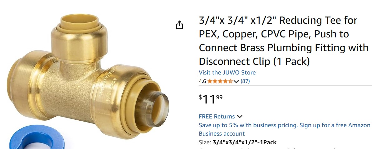

II put my air lines in 30 years ago also. All that was available at that time was air hose in 15- 20 ft lengths so i made that system. Today the most common system is PEX... just like your floor heat. You can make the lengths any length you want. In the Sons shop/ barn I put fittings at 20 ft intervals and you never have to move the compressor.  Run a line upstairs and put 1-2 in the attic also.  1/2 inch ID pex ( .485) is plenty big compared to the fittings on the ends.
Edited by steve(ill) - 26 Dec 2020 at 8:41am

On the air line I do have a bunch of PEX. It says 100 PSI max on it. My compressor will put out a little more than that but for most things 100 PSI is plenty. I may look at that a little more too. Would need to find fittings and tool to crimp.

About the 8:30 mark on the movie , it shows the crimper and clamps i bought from Menards to use on the PEX air lines.. The brass fittings are the major cost of the system, not the tool, clamps or pipe...  They have TEE, 90 degree, and end like you would put at the top of a shower head (  pex in, 1/2 inch pipe out) to get to the valve or coupler at the end of the line.
Edited by steve(ill) - 26 Dec 2020 at 5:02pm

Runnng air is no different than water in a house. The 'mainline' needs to be 3/4" or bigger THEN you can have runs made of 1/2". While your current pressor is only 100#, when you replace it, odds are the new one will be good for 135 or 155#, so best to install 'future rated' lines today...save the labour & cost of upgrading later,let alone the pain of looking the guy in the mirror and saying 'I told you....."
Each 'drop' or 'station' or whatever you call them should have it's own  regulator/water trap unit as well as a shutoff(before not after...) .
All lines should be sloped away from the tank so water will accumulate in the water traps. A 'drop' consists of a shutoff then T fitting then4" nipple then pipe cap. The center of the T goes to the regulator and filter then quick connect. Yes it's a lot of plumbing,but you can slowly add 'drops' as required.
Always a good idea to get a drop near every door and every corner.
Another one of those 'do as I say, not what I did' sayings....

Here's the pex tool I bought when I built our house. It has all the different size dies you'll need.
Apollo     Multi-Head PEX Crimp Tool Kit
https://www.homedepot.com/p/Apollo-Multi-Head-PEX-Crimp-Tool-Kit-69PTKH0015K/202525483
">Home depot pex tool

Looks like we now have a PEX information central spot! I will try to look at and absorb all of this thanks for posting! I may get the PEX crimp tooling and use the same for some of my waterlines also!
I did look at the PEX that I have from the floor. It says PEX-b on it. PSI ratings looks good at like 175 PSI IIRC. It is only 1/2 inch so there might be some pressure drop in a long run.
