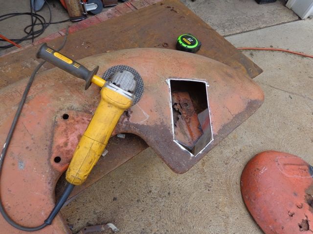

Post Options Post Options   Thanks (0) Thanks(0)   Quote Charlie175 Quote  Post ReplyReply Direct Link To This Post Posted: 29 Sep 2016 at 5:08am
I was slacking and didn't take pictures.
The portion above the bolt mounts was bad so I cut that and put in a new patch. I was having burn through issues on my wire feed even on the lowest setting. Ended up putting a lot of wire on it and grinding it down but it did blend well.
I was going to leave the tack weld dips as is as they must have come from the factory that way but then I saw yours and decided to blend them in.
I tried to shape the fenders but I really need an English wheel, they will have to suffice as is.
Trying to patch two dents on the top of the nose piece. Contour blending is hard!
I think it looks good and then shoot it with primer only to discover flat spots or something else needing redone...
Charlie

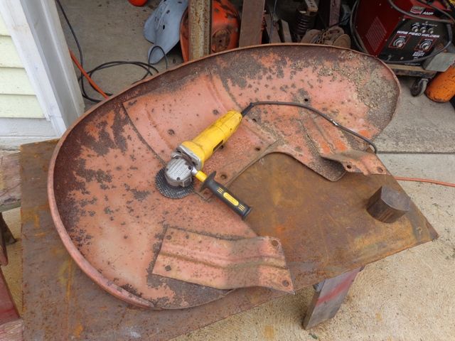

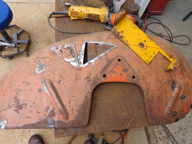

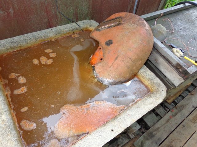

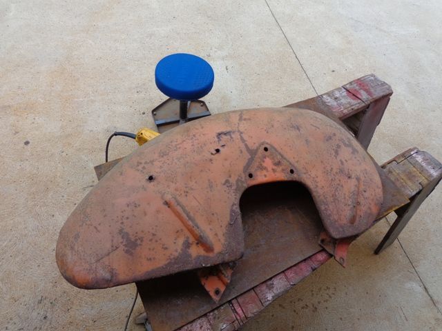

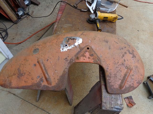

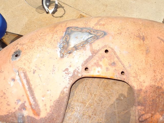

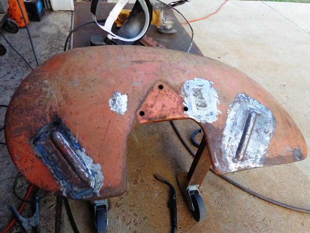

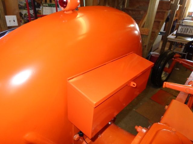

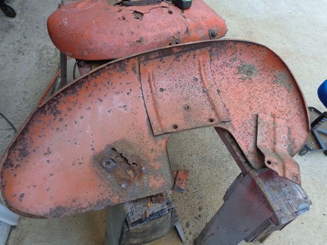

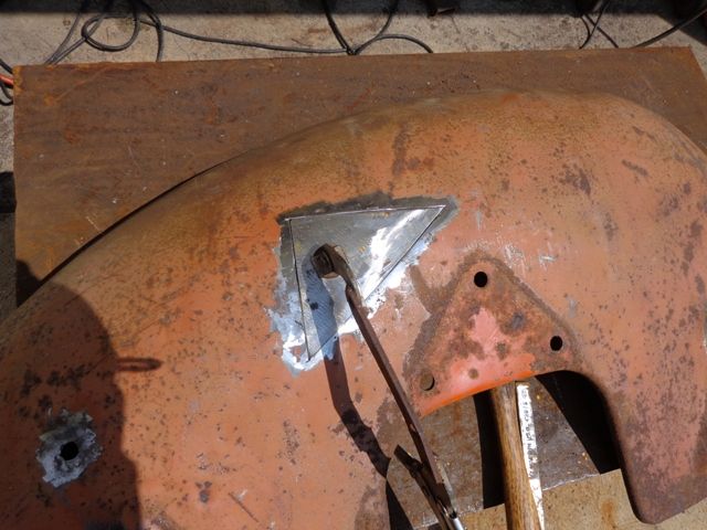

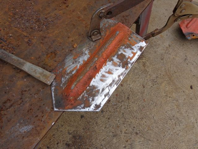

Post Options Post Options   Thanks (0) Thanks(0)   Quote Sugarmaker Quote  Post ReplyReply Direct Link To This Post Posted: 26 Sep 2016 at 5:12pm
Charlie,
You asked for it!:)

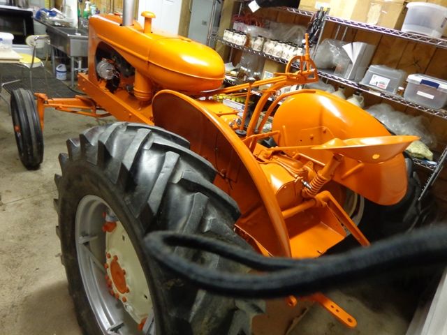

 Here are some pictures of WD fenders and the repairs, and finished product.

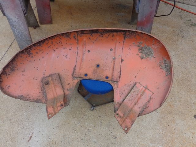

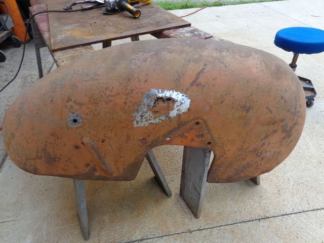

This set was purchased at a flea market. Don't let the shiny orange paint fool you, they were in rough shape. Dents all over and lots of rust.

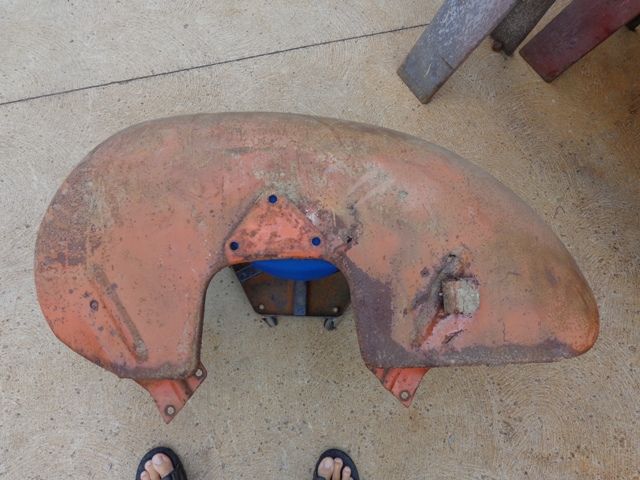

Here is a set of WC fenders I converted to WD. They had rust in all the right places, and needed some attention too!
hot dog shape from original tractor donor fender

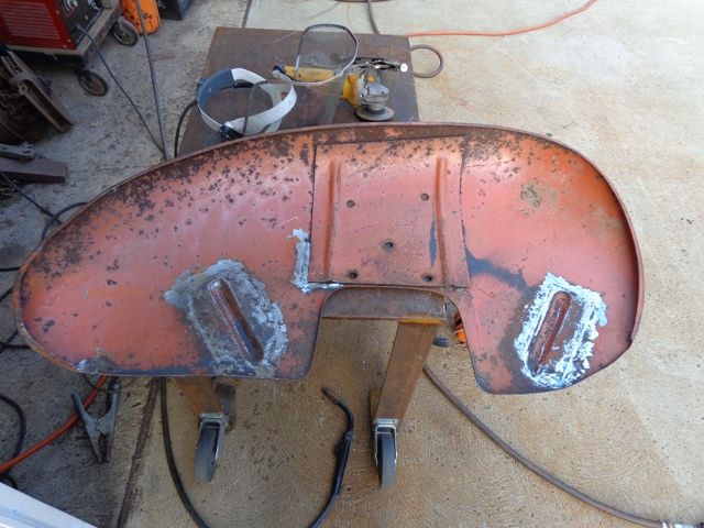

more holes
more patches
shapes welded in place

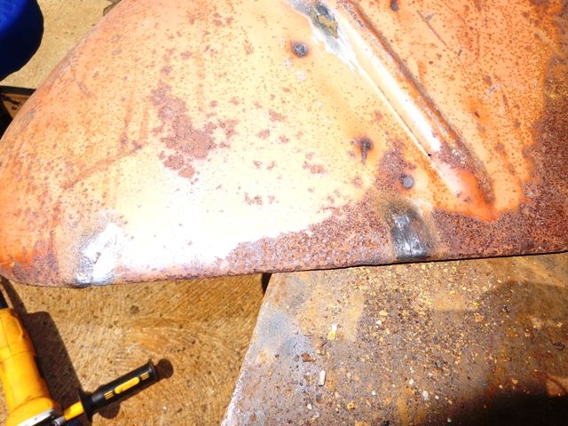

several torn areas welded.
into the e-tank
some filler, sanding, primer, and PO#1!
The other set on the narrow front WD.
By the way these are like sanding a jelly bean! Sand in all directions.
Edited by Sugarmaker - 26 Sep 2016 at 5:16pm
